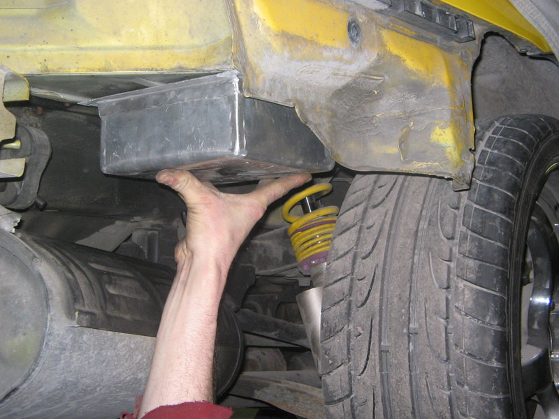

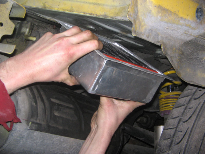

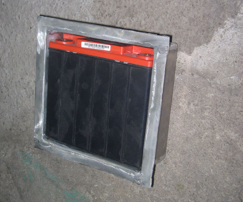

Get a Odyssey PC680 drycell battery. They're not too expensive and work just as well as all the other small batteries if not better. More info HERE
I installed mine under the trunk on the passenger side. Fits like a glove.

did u make that metal casing?

Yup, made the casing from aluminium. Basically traced it on a sheet, cut it in 1 piece, then folded. It doesn't need to be very thick. On those photos, it's still a little rough, but it's quite hidden so even after the final touch up it doesn't differ much.
