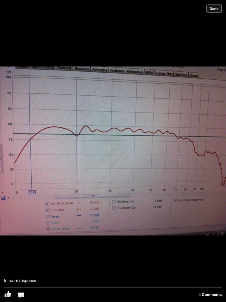

I've been doing the 'tuning' for years now. I have always found I get a better sound, or a sound I prefer by using my ear. I've made the response perfectly flat in my room with 'tuning' and didn't like the sound at all.

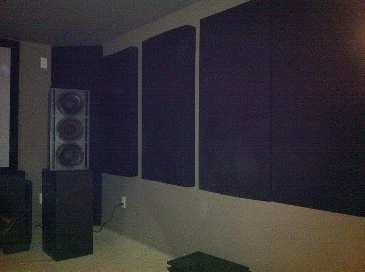

Also if you have been "tuning" for years now I don't see a single piece of acoustic treatment in your narrow room so my guess are time delay cancelation from reflected sound that arrives ms behind the original one and also massive comb filtering with good size cancelation dips I have attached a room I did to show you the acoustic requirement of a narrow room like yours that I did a few years back I also included a frequency respond of the bass to show you how the room reacted to all of this

I have all types of graphs from my room as well, including testing the the subs I built (there are more than what you see behind the stage).
