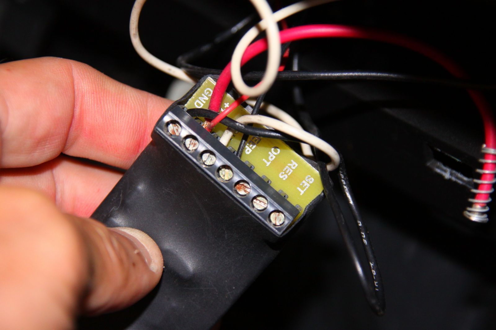

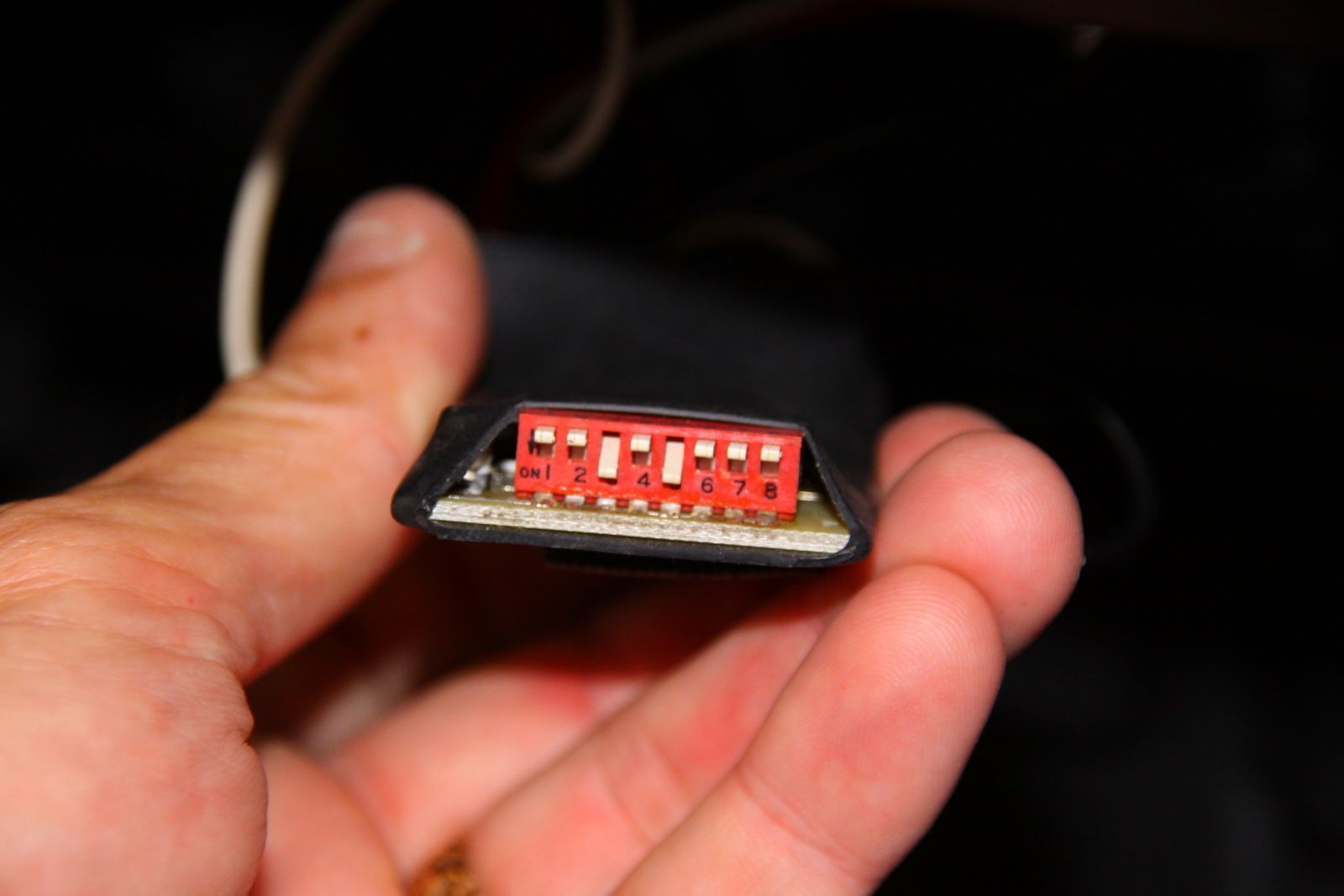

While installing my satellite radio I popped off the passenger side under dash pannel and found this device.
The fuse holder is broken so it is not energized. It has +/- 12V and a white wire that runs to a terminal block. There is also a small electronic beeper hooked to it.
I have had the car since 2005 and never have been up into that side of the dash before today.
Comment appreciated
Old Mar 22, 2009 | 10:22 AM
Nickamsweet's Avatar
Joined: May 2008
Posts: 2,016
From: Scotland
Is your s2k a Japanese import? As could be a de-limiter but doubtful...
try tracing the non power wires (basically the signal ones) and see what it connects too
Old Mar 22, 2009 | 01:09 PM
Sobe_Death's Avatar
Joined: Nov 2004
Posts: 1,239
Likes: 13
From: Denver
maybe a redline shift beeper?
Old Mar 22, 2009 | 03:33 PM
G's Avatar
G
Joined: Nov 2007
Posts: 5,100
Likes: 6
From: Maggie Valley, NC
Do you have an aftermarket HU? Do your left side dash controls work?
Could it be some sort of DCI?
Old Mar 22, 2009 | 03:45 PM
Swags04's Avatar
Joined: Jul 2003
Posts: 171
From: Central
looks like a dci to me
Old Mar 22, 2009 | 03:47 PM
captainbk's Avatar
Joined: Oct 2005
Posts: 7,279
From: Bradenton, Florida
That was my first thought. Trying to recover some brain cells.....When I first got the car I recall hearing a readline beep. then it quit and I never looked into it.
I have DCI and it resides under the radio.
Old Mar 22, 2009 | 05:19 PM
Slows2k's Avatar
Posts: 45,407
Likes: 433
From: Mother F'in TN
Modifry's shift beeper installs behind the passengers side dash panel, looks like one to me.
Old Mar 27, 2009 | 04:56 AM
captainbk's Avatar
Joined: Oct 2005
Posts: 7,279
Indeed, that is what it is. I replaced the fuse holder and it works. Not that I can hear it all that well with the Invidia Thanks to all
