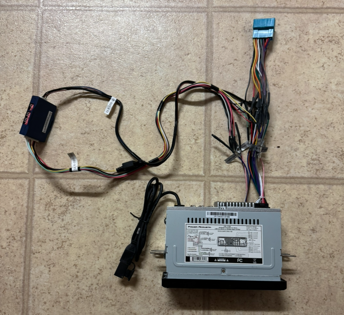

No splicing into OEM wires. The generic Honda plug and play harness does not have pins in the #3 and #14 location for dash controls. You can either buy another $6 patch plug or de-pin and transfer the pins to the empty slots so the SWC box of your choice can talk to the car.
Here is my plug and play harness before looming.

pressing the dash controls has no delay compared to modifry, for example changing modes would have a delay or wouldn't work and sometime pressing multiple times ait would glitch. we did use an old modifry dci and couldn't figure out how to get it to operate properly as our mode and channel buttons were flipped. the PAC system is on sale and i would highly recommend as most of my friends and i swapped over at $40 cant go wrong. last adding pins to #3 and #14 is easy as you can take it off your old connector by depinning with a needle or pin and connecting it your new connector which will make it plug and play. if you haven't depinned a connector before you can just tap those wire on the dash harness side whichever is easier for you

what he said ^^^ i should have taken pics of my harness but i was too excited to get it into my car lol
