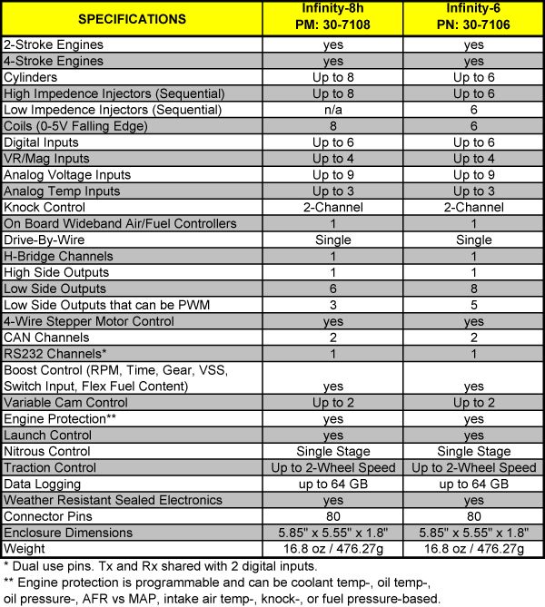

So.... as I continue to save for the Aem infinity, please help tell me why I shouldn't get the 8h. The 8h is $100 less than the 6h. My goals are is to install the J motor once 2ners completes the mounts ect..... As of now I am stock. (bolt-ons)

The main reason to get the 6 is to drive the factory coolant gauge. The 8h is missing the output needed for that.

Since the Infinity 8H can drive two additional coils/injectors, there are less available lowside outputs (the hardware needed to come from somewhere). Also, the Infinity 8H can only drive high impedance injectors whereas the Infinity 6 can drive both high and low. Unless you're going to be running an 8 cylinder engine, I would ALWAYS recommend an Infinity 6 over an Infinity 8H. Think of the Infinity 8H as a budget 8 cylinder box over the regular Infinity 8.
