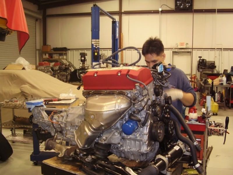

My setup is an '05 with a KraftWerks high boost kit (10 psi) with stock header, cat, and exhaust.
In addition to the KW SC kit, I supplied:
RC 650 cc injectors w/plug and play clips - about $450
Walbro fuel pump - about $100
Hondata K-pro ECU - $1800
Hondata intake gasket - $60
Valve cover, sensors, etc. for K-pro conversion - about $300
ACT HD pressure plate - about $525
Stock disk - about $120
Stock release bearing _ about $125
Spark plugs, oil filter, Mobile 1 oil - about $60
Tuning - $350
Sub Total $3885
Kit $5495
Grand total $9380
I removed the engine because I was replacing the clutch and had initially intended to install a thicker head gasket. Lowering the compression is not necessary or advisable. The supercharger install was done after the engine was re-installed. Removing the engine is not required.
Protecting the paint
Driveline removed
Owner supplied parts (Injectors and K-pro not received yet)
Kit parts
Sensor install
Clutch
Intake gasket
FMIC install
Hondata K-pro install
Pictures of engine bay coming (forgot where I put them )
Scan of original printout from last dyno test
Overlay of KraftWerks kit results on my previous Comptech vs Stock results
