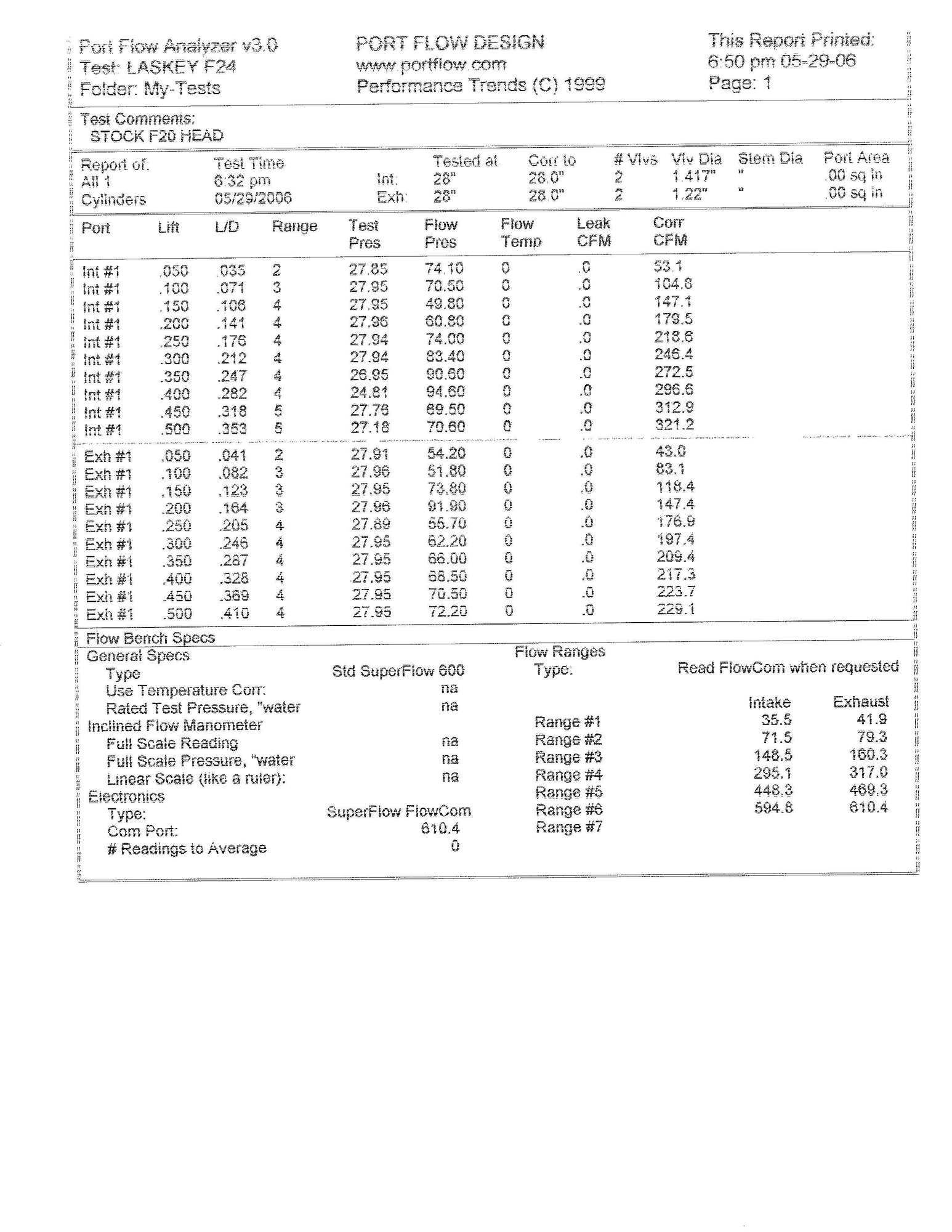

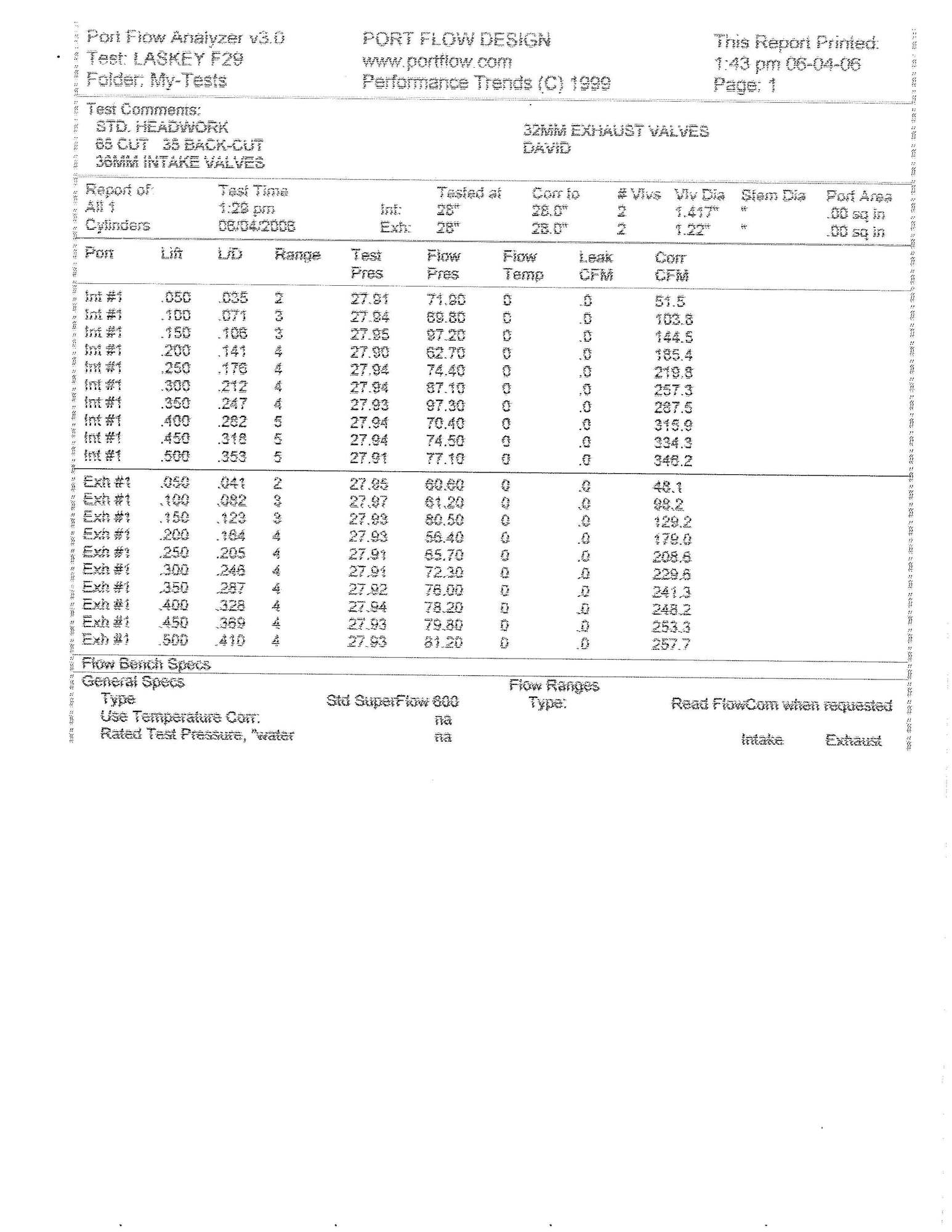

Before & After... head was a core Earl had in stock, not mine.
Before:
After:
