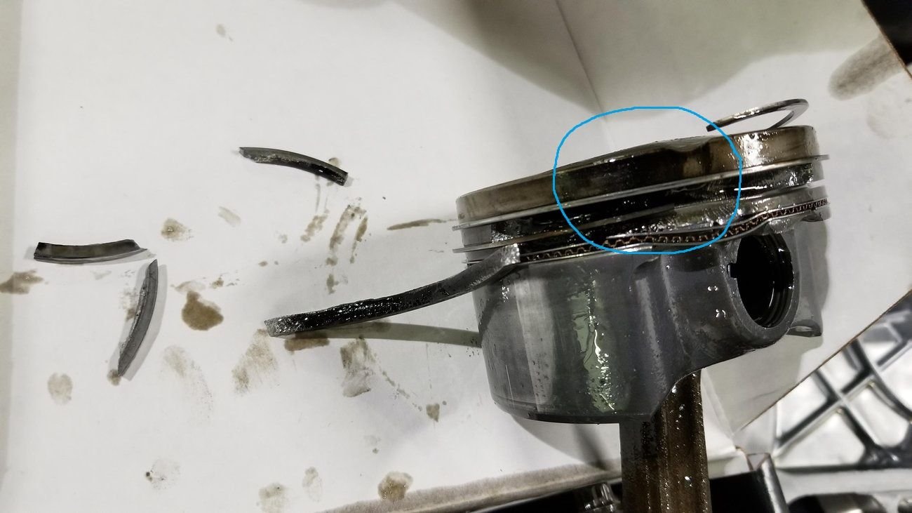

This aligns with cylinder binding to me. Large chunks of ring lands broken and damaged or torn off piston crown.
I'm leaning towards mechanical just because:
1. We see zero peppering/sandblasted look on top of 2 bad pistons from suggested "constant or heavy detonation".
2. We're told plugs look fine. Simply soaked in oil instead of "extreme detonation" where they'd be exposed to extreme pressure/temperature that'd start melting them or at least we'd see "popcorn" like, so melted aluminum material from the piston be present.
3. If he had misfires he would most likely feel it with 1 cylinder never mind 2. Hondata, being basically OEM ecu also would've thrown a CEL for sure.

Hi all, I've contracted Evans (Jeff) and he is reviewing the tunes/logs from my tune. Inline Pro is to be measuring the bores at the beginning of this week to make sure we can even still stick to a 2.2 for the rebuild, and discuss options from there. I'll keep this updated as things unfold.
Update:
I wanted to give all parties a chance to respond before posting an in-depth update.
Evans reviewed the logs and showed that the AFR was 13+ and encountered over 100 counts of knock in a single gear pull during the time of failure. The motor leaned out like crazy, he said he was surprised that this lasted as long as it did. That's what killed the engine.
Why did it go so lean? When the engine was being built, I was told that I would not need a re-tune. (IP assumed the engine was tuned when it was healthy) I followed that guidance. I have since learned that if I had a tune done on a motor that was having blow-by issues, then had that motor rebuilt.. now the new motor is sealing in all that air into the cylinder instead of it blowing by - causing the extreme lean condition.
I'm disappointed in myself for not thinking of such a basic thing. I've been wrenching and modifying my own vehicles for 15 years now and didn't think to myself that this thing should get a re-tune because of the blow-by. Very expensive lesson learned.
So where do we stand? Well, inline pro are doing their best to source a good donor block and are going to waive most/all labor to rebuild this. At minimum I'm looking at new pistons, rings, engine bearings, headgasket and machining the donor block. We're shooting for 2-3 weeks from now to be running again. Inline have been great to work with throughout this and John in particular has been very patient with my million questions about all of this. For anyone in the future that reads this, I would not hesitate to get work done by Inline again.
