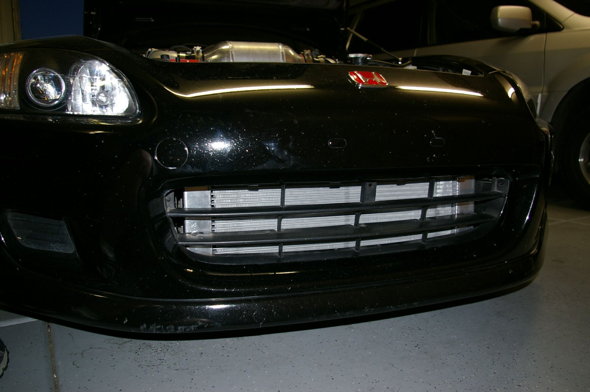

Originally Posted by jwa4378,Oct 30 2007, 05:16 PM
Awesome. Are you going to run an intercooler / aftercooler? I am assuming the kit will come with all the AC lines?
John
I am currently running an air to Water IC (pic below) - it has proven to be quite efficient and effective here in the Arizona heat (115+ during the summer months).
I discussed the AC line options with SOT and the thinking is that they will offer the kit with the AC lines as an option. Some people may elect to have their lines modified locally, where as others will want to order them with the kit. I had my AC lines modified at a local AC shop for $108. I recharged the AC system myself, but would estimate the cost at about $60-80 if you paid an AC shop to do it. The entire AC line mod job with recharge should not cost more than $250.
I am not sure if they will offer the IC kit as an option or not. Someone may want to try an air to air IC at some point though.

What is that bulge in the intake plumbing of the non-IC picture? Looks different from the piping on Page 1. Also, that piping is REALLY close to the passenger Strut Tower... How much does that thing move with the added torque? How close does it come to hitting/rubbing?
John
