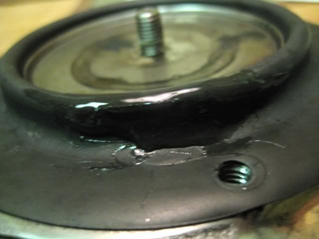

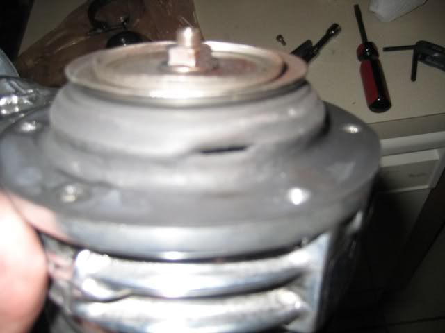

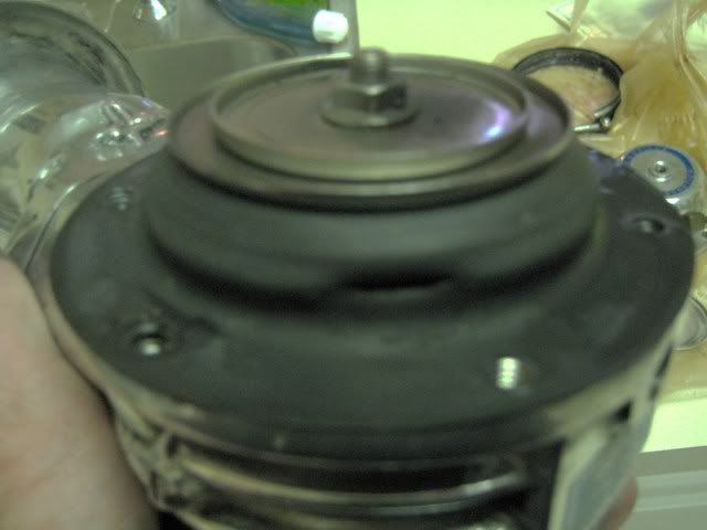

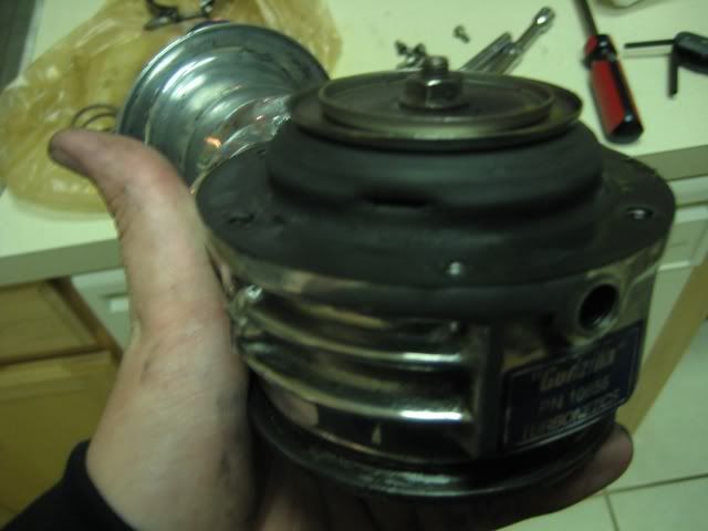

After taking apart the BOV, this is what I found...
There is a tear in the gasket inside the top hat.
I have attempted to seal the tear using aquaseal (rubber repair glue and sealant used to fix wetsuits, rafts, etc....
Hopefully this will hold until I can replace the gasket.
-Matt
