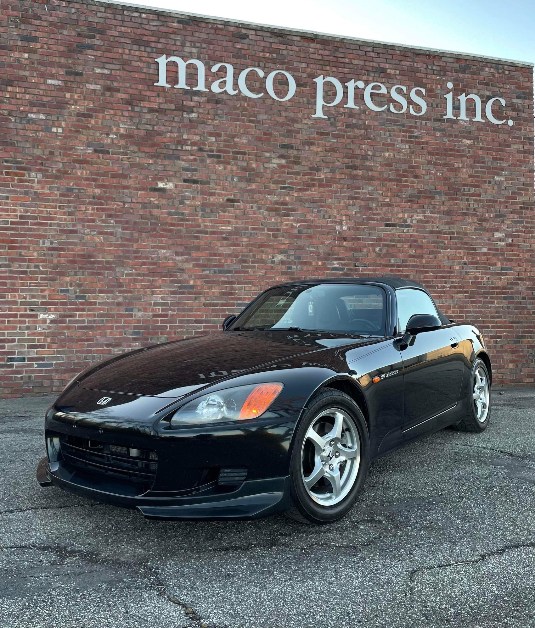

Hello! This is my first post here so I’m sorry if im in the wrong area.
A couple days ago i acquired a beautiful 2000 S2k with 112k miles. The car has a comptech Novi 1000 Supercharger, aftercooler, and a haltech ecu. Im relatively new to superchargers and especially s2k’s. I was driving and under WOT heard belt squeal, popped the hood and the supercharger belt looks relatively loose to me. Has maybe 1/2 inch of play. I was wondering if this belt needs to be slightly loose, or if it needs tightened.
i also would like some information on if i need to service the kit somehow, or if theres any extra maintenance i need to do with this kit.
the oil drain from the supercharger goes directly into the pan via the oil plug hole. Do i take the line off for oil changes?
Sorry for the newb questions, just excited about the car and trying to learn all i can.
Thank you!
