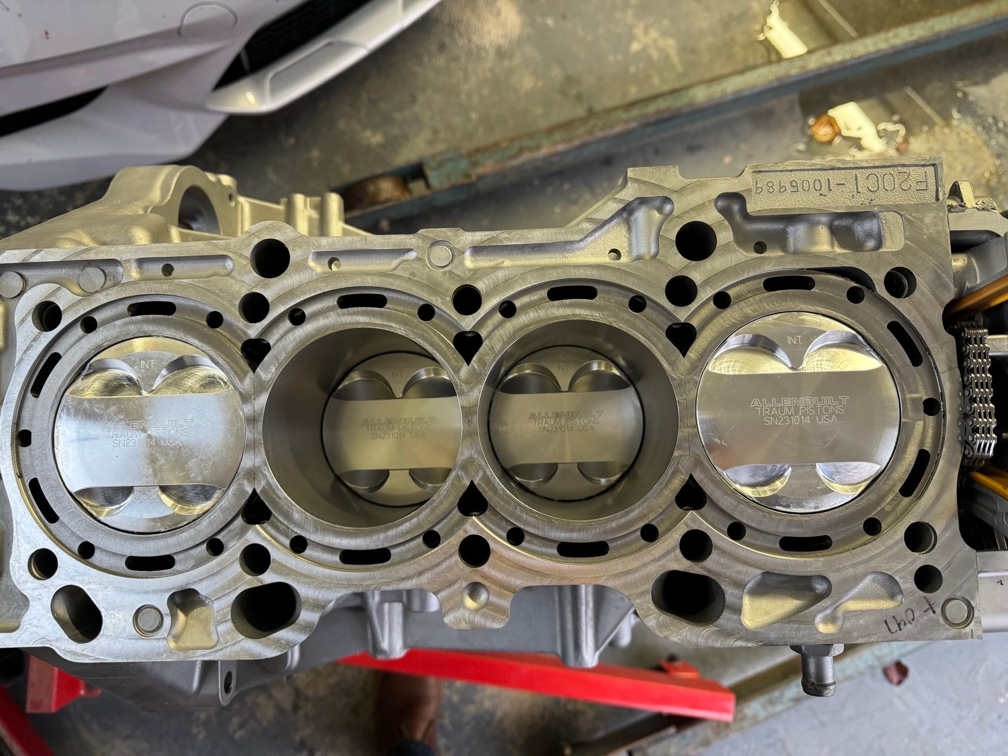

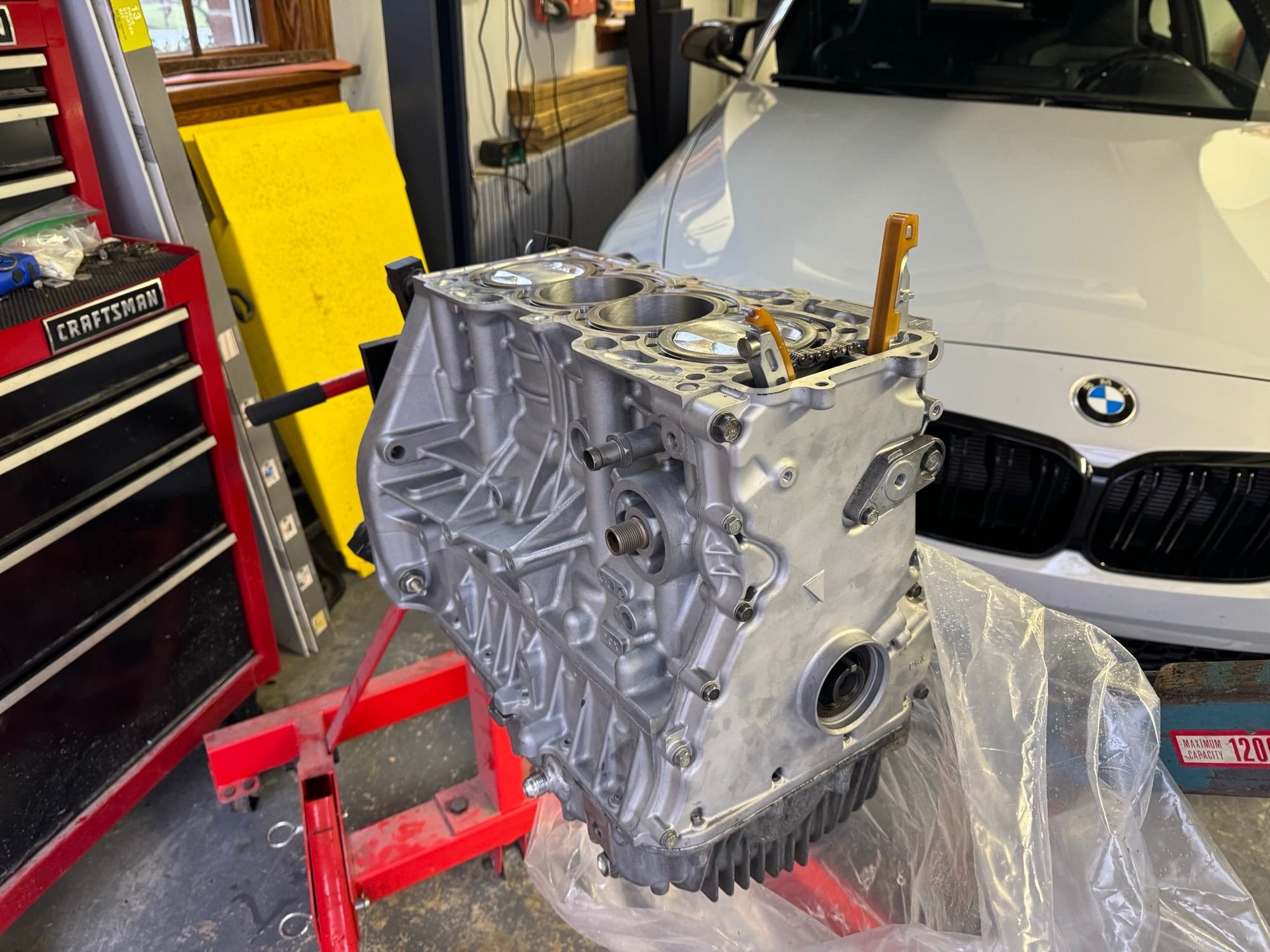

Picked up the rebuilt motor from Jeremy Allen today. Now with 10.5:1 pistons, fully sleeved, cylinder head repaired, etc. She's looking pretty!
I should have a decent amount of time this weekend to start assembling it back together before going back in the car. I also plan on going to a full SOS return fuel system before the car goes back on the road again, as well as a few other odds/ends. I really hope this one lasts!

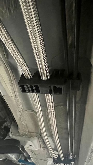

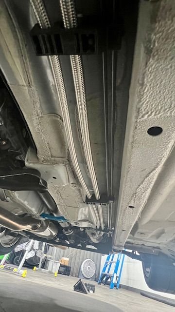

Engine is looking amazing! And I don't believe you'll have any issues going forward knowing that Jeremy built it.
If I could make one suggestion - don't bother with the SOS return kit. The stock fuel return line is just too damn small; I don't care what anyone says.
I actually ended up getting the fuel line holders from an 06-09 like on your car; they're PERFECT for a PTFE -8 feed and a -6 return....like, too perfect. Save yourself some money, and have a better fuel system at the same time. Win/win. Check it out:
Very cool! I hate to ask this but can you send or PM me a parts list and a general how-to on this?
I know the SOS kit is overpriced but it’s also a complete diy kit with clear instructions, which I appreciate.
I’m an amateur when it comes to fuel systems outside of fuel pump changes or injectors, but I’ve assembled engines, installed FI, etc so I know I’m capable of this, just need some guidance.
I would greatly appreciate you sharing your specific setup parts list!
