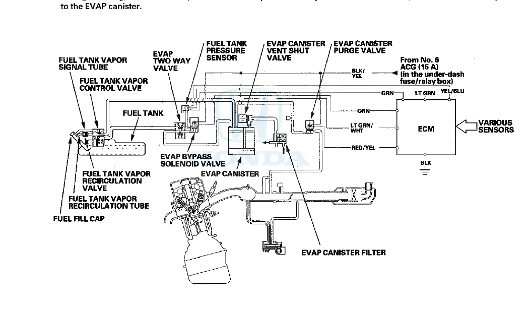

Id be halfway interested in designing a circuit board to keep the evap system operational without the OEM ecu. Only problem is I don't know jack shit about how evap systems work lol.
There are a lot of control valves and a fuel tank pressure sensor. It shouldn't be too difficult to control if one knew what needed done.
There is a lot of information in the service manual on it. I might have to do some digging, but if anyone has a TL ; DR for how this system works (what valves need open/closed and when) I'd be all ears.
