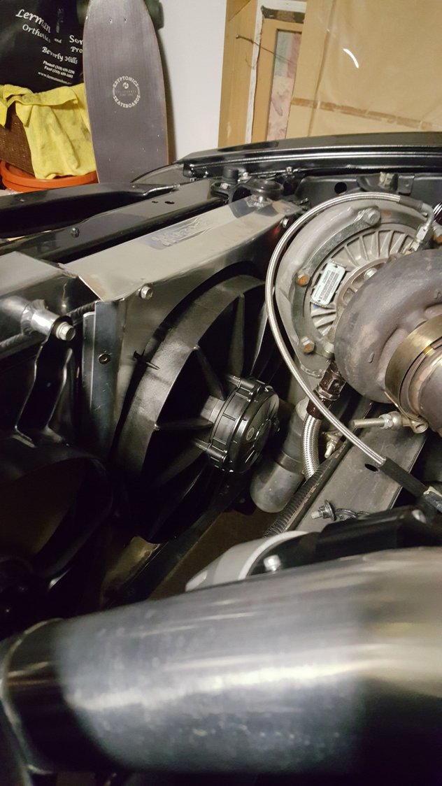

So I have some updates on this. I finished the install on my spal 12" extreme fan with custom shroud. I used the spal relay wire kit ($150!). I tucked everything away under the passenger side fender. The engine does not get affected when the fans kick on, nor do any of my other electronics. However, with the fan on, I noticed my voltage dropped to 13.4-5 from 13.6volts...draws more amperage when in operation i guess. My fans are set to turn on at 170deg F so technically once they reach that temp they're always on (I may change this down the road).
I'll be driving the car in traffic tomorrow so that will be the true test but I just couldn't resist the urge to update you guys on the progress lol. I drove the car a couple times with the new fan. One time was a 40min cruise going on avg 75mph on the highway in 75deg F weather in and out of boost. The temps stayed consistently in the 185-188deg F range. Way lower operating temps than what im used to. I may change my fan to turn on at 185deg F. At one point my temps even dropped into the 170's. All i can say is from the looks of it, this fan definitely gets the job done. Now, I need to search what normal operating ECT for the s2k should be so I can adjust my fan temp control accordingly.

From the factory, the fans kick on between 196-203 and turn off around 10 degrees cooler than the on temp.
I personally don't consider the car warmed up until I see 176. I have my fans set to come on at 198 and shut off at 185. When cruising I am usually seeing around 180-185 temps.

No reason to turn the fans on at anything less than 190 ish degrees. Thermostat starts to open in the 170 range and it's not fully open till around 190. Let your cooling system do its job. Stock the fans turn on around 195 and turn off around 205 - you should be replicating that.
