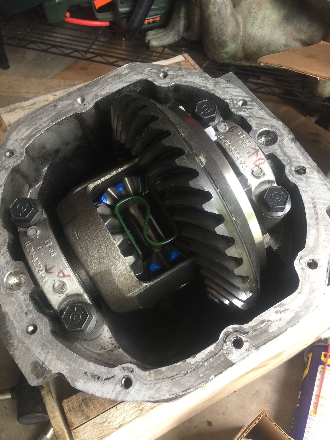

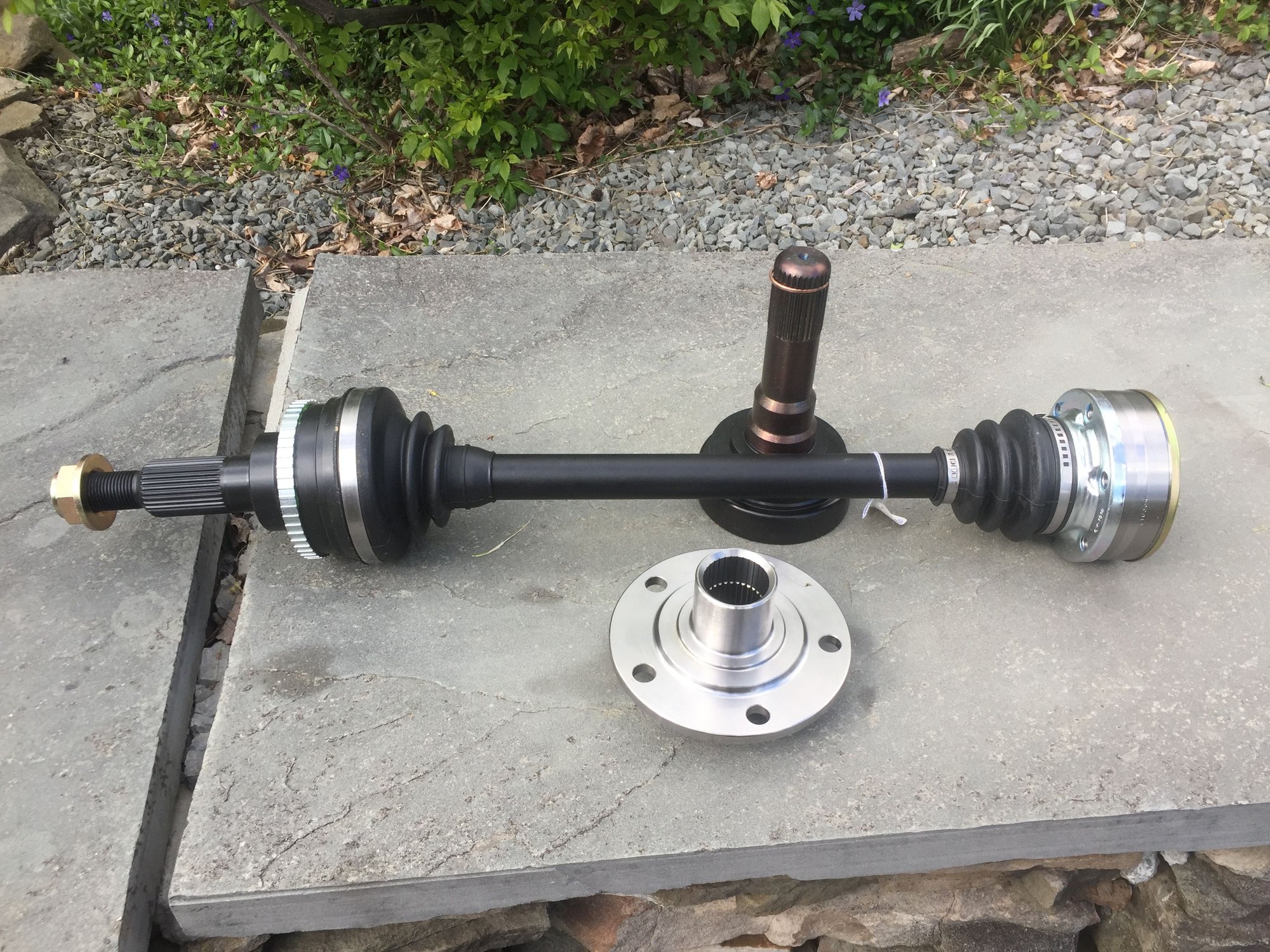

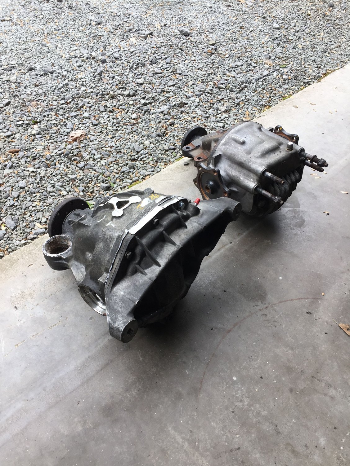

  #95
jordannn93's Avatar
Joined: Apr 2011
Posts: 1,419
From: Olyphant, Pa
Installed x performance 8.8 kit with dss 5.9 axles. Installed a ford racing lsd with carbon clutches in the used diff which I got from a 2007 explorer. It has 3.73 gears. Also installed 15x10 +44 race star wheels with 270/50/15 et street tires. They are a direct bolt on that required no grinding of the brake caliper.
