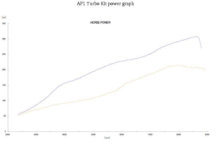

Yep very conservative tune, but hey its just a safe starting point.

Originally Posted by S2Kart,Oct 3 2007, 06:31 PM
metric
302WHP forgot the TQ now, think its 200 ft lbs
-From Trust (parent company of Greddy)
CAT IN PLACE, 60mm exhaust
Mitsubishi T5-18Z turbo is ~.74 A/R, similar to a GT30
A GT30 can do 30PSI easy. When I spoke to one of the Greddy reps they stated the T518Z can only do 16 PSI max. Why do you say the T518Z is similar to the GT30?

turbines are comparable not the compressors
True - the similarities are only good through 15 psi, which is the pressure that turbo flows are typically mapped at. I bet if you change the Mitsubishi WG spring you can go higher PSI if you really want to.
The T5-18Z 10cm2 turbine AR is .74. Also, its' compressor map from Mitsubishi Heavy Industries is very close to a GT30. The Mitsu is twin scroll - dont' know what the GT30 has.
Based on this I'd say they are similar, but need to add "up to 15psi". I suppose I'm looking at it from the point of view of staying at 10psi max for my application.
-Doug

I'm loving those curves. Especially that fat torque curve! 202ft/lb at 3910rpm. I can't wait.
