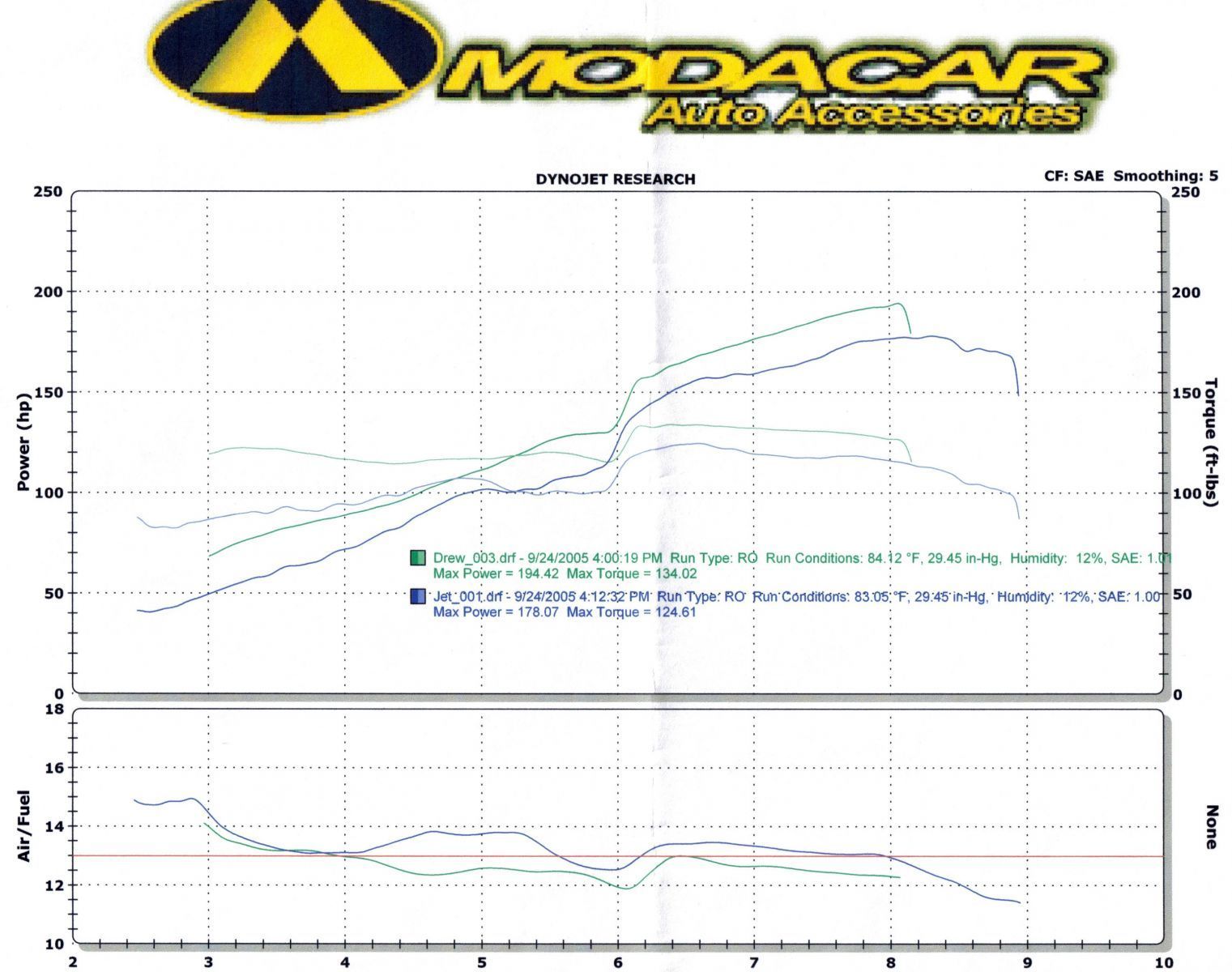

Jet, here is our dyno before the turbo at Modacar. Jet is the Blue and I am the Green.

^^ so what are the specs on your unknown dual exhaust? piping diameters specifically?

^The midpipe is 63mm and then split off into dual 50mm.

are you using a cat or testpipe?

He's running stock cat
