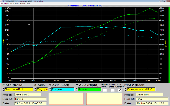

Originally Posted by devs2k,Apr 10 2008, 01:08 PM
7.5psi, 290 whp, 210 ft lbs from 3750 to almost redline
http://www.holyrollerdyno.com/Holyroller_D...sition=download
What exhaust and did you have a test pipe in?
Nice numbers there.
Nice numbers there.
sorry forgot to mention that.. stock cat, that is why it boosts up to 7.5 around 4k and down to 5.5 or so by redline..
You need a high flow cat if your boost is dropping off in the high RPM's.
Was that with a 70MM single exhaust or stock or?
