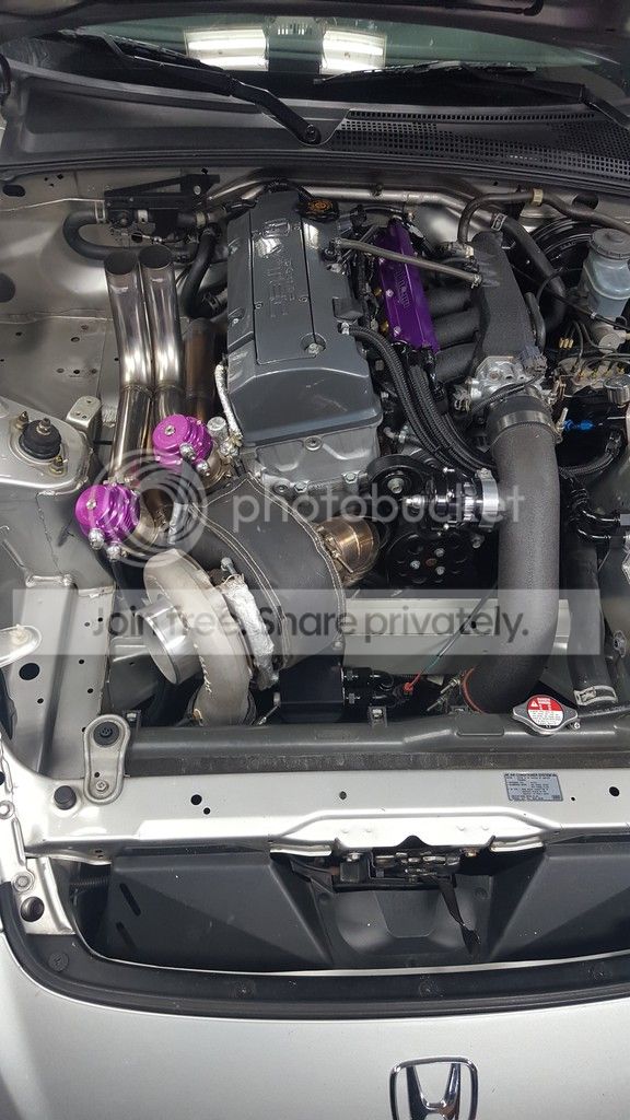

Got any pics of the engine bay and turbo setup??
Sure. I'll run out to the garage and snap a few. How's your car running Benton?

Old Mar 11, 2016 | 03:19 PM
  #96
wy2slow_z's Avatar
Joined: Sep 2009
Posts: 871
From: 540
670 @30 isnt great. couple people have had problems with twinscroll setups at the .91ar. but like you said, bump that housing up and you should be fine.
Yeah. Granted, this is a low compression engine as well. I'm really leaning towards going with a bigger housing/billet wheel (as opposed to just a bigger housing).
