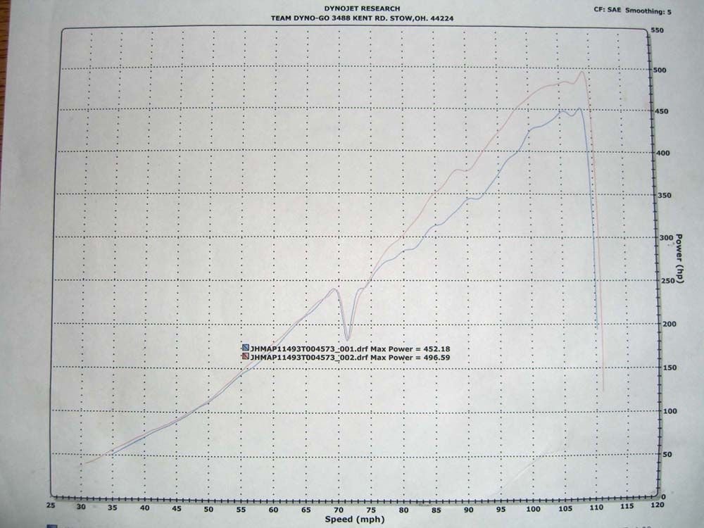

Iv made 497rwhp @ 24psi, but that was without the water/meth injection setup. I never had a chance to fully tune/dyno my car with it. My cars been down waiting for my InlinePro block to be installed. Im hoping for sometime next week everything will be done.
On 93 octane?
Good luck with that new motor! I plan on having my bottom end built at some point, but for now I am going to take it to her limits!

Originally Posted by 2QYK4U,Oct 11 2007, 11:00 AM
On 93 octane?
Yup, that was on 93 octane.
Thxs bro! Good luck with your setup also. Keep us posted on your results.

thats crazy though, you needed 26psi to hit 500whp, and reborn56 needed only 16 on a FR manifold! what was your torque?
Old Oct 11, 2007 | 08:52 AM
OGPackin's Avatar
Joined: May 2003
Posts: 931
From: Boca Raton
It was @ 24psi
That day there was no torque graphed.
The max torque iv graphed on a dyno is 300.01
