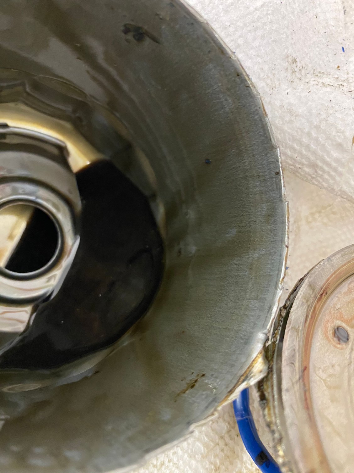

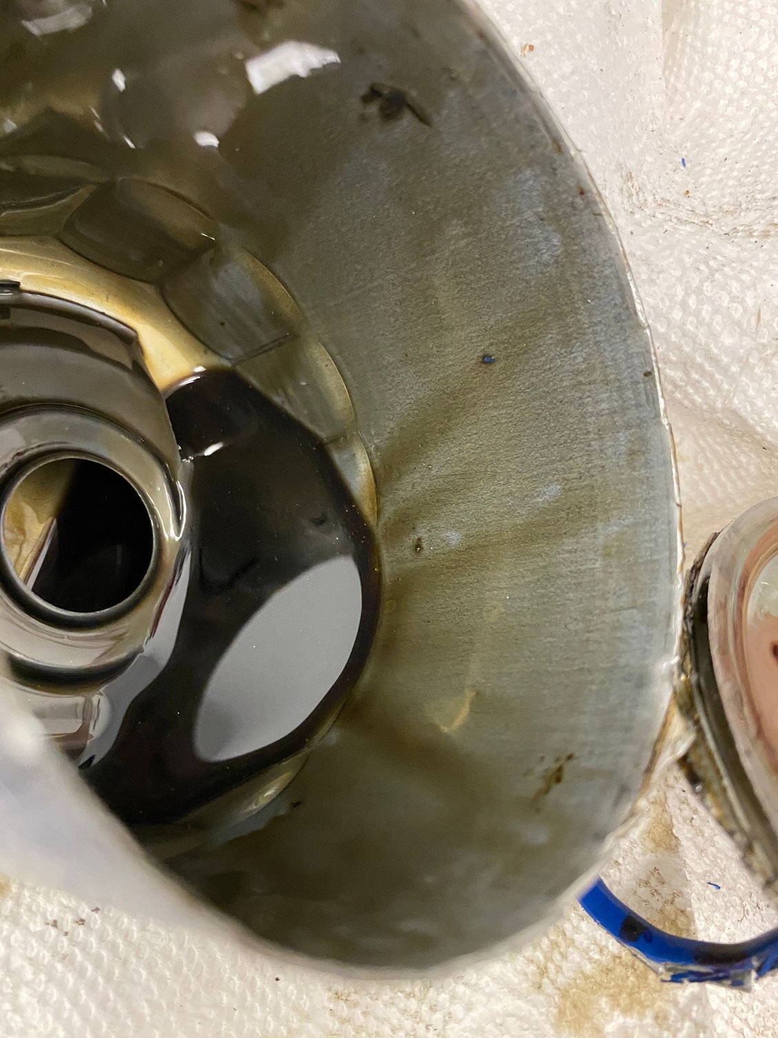

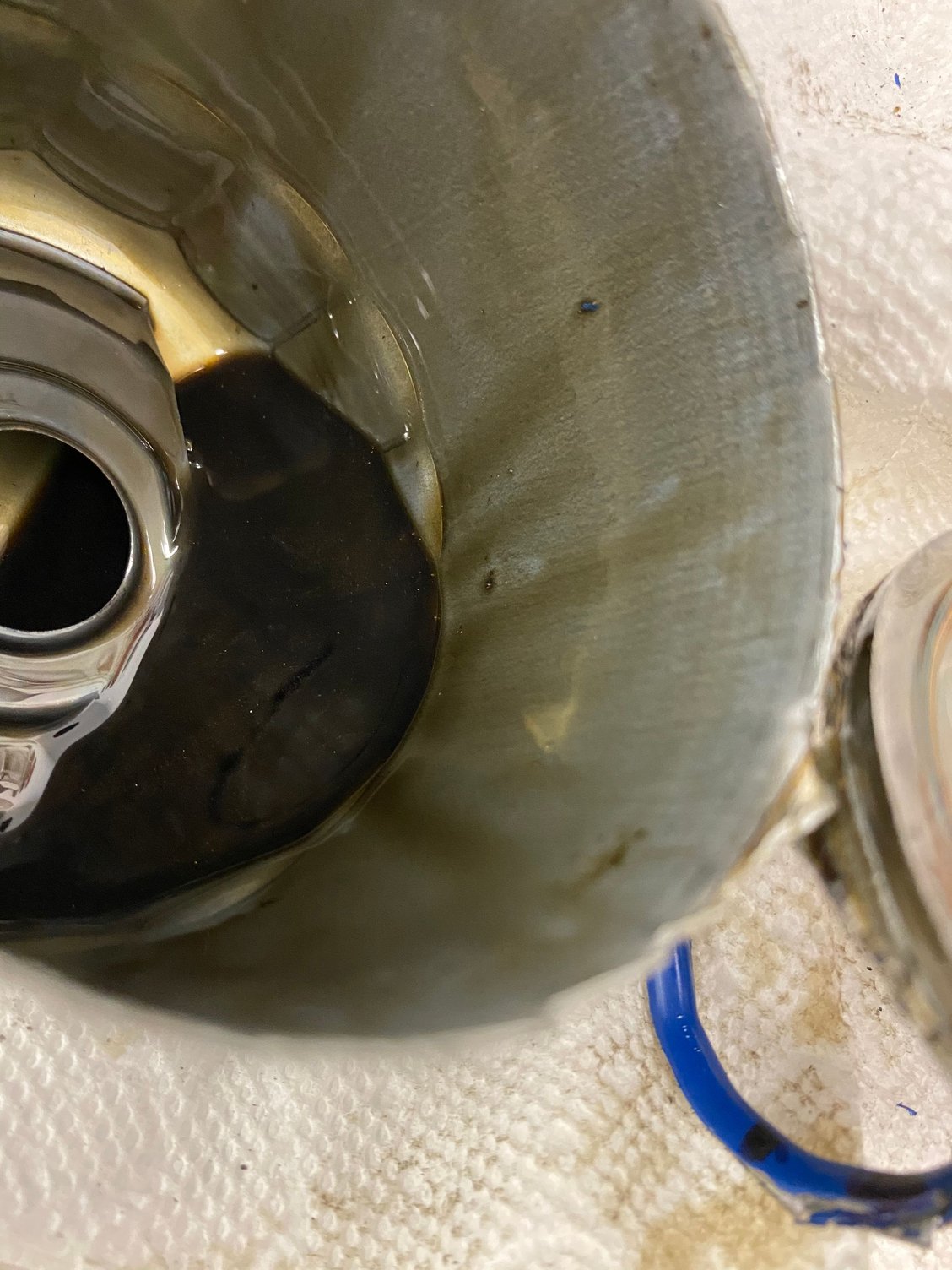

Cut apart the oil filter today.
I tried to get pics, hopefully it comes through. The oil in the filter looks like one of my daughters glitter projects... The filter media has gold and silver pieces all through it. I’ll get better pics of it later.

I can see it in the last pic. Sorry to hear. What are your plans with the motor?

did you drain the oil for an oil change? there should be way more in the drained oil than in the oil filter, though it likely doesn't matter. sorry to hear, that sucks.
No idea, I'll part it out this winter I suppose. I doubt there is a market for a built motor with a bearing problem.. haha.
