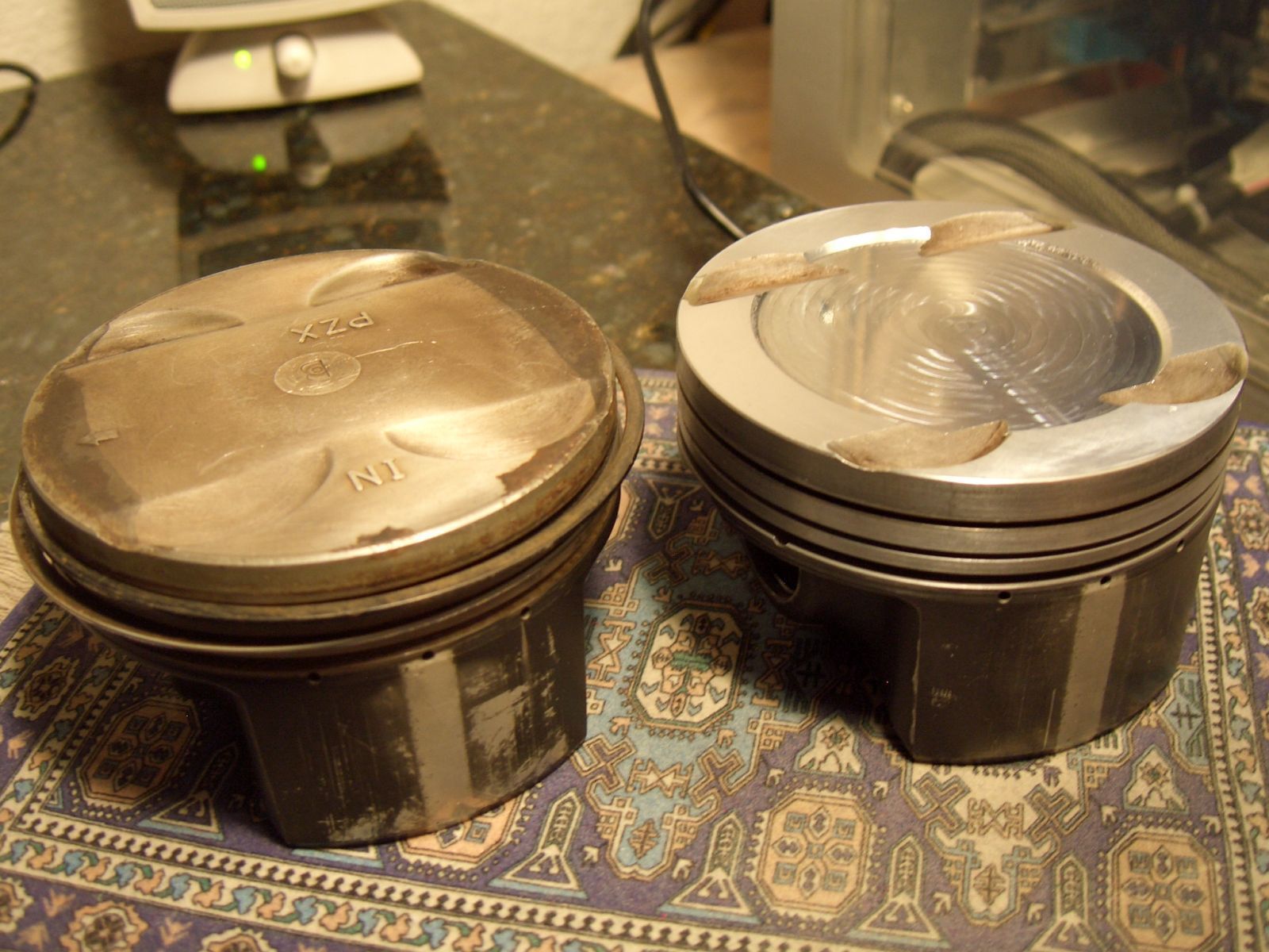

Wow! It looks like the AP1 pistons would be stronger for boost with .075" thicker material on the piston head. I hope getting it down to .170" doesn't make it too weak for boost. Good luck.

I would try to remove material from the triangle between the valve reliefs so you don't have to remove as much off the crown.

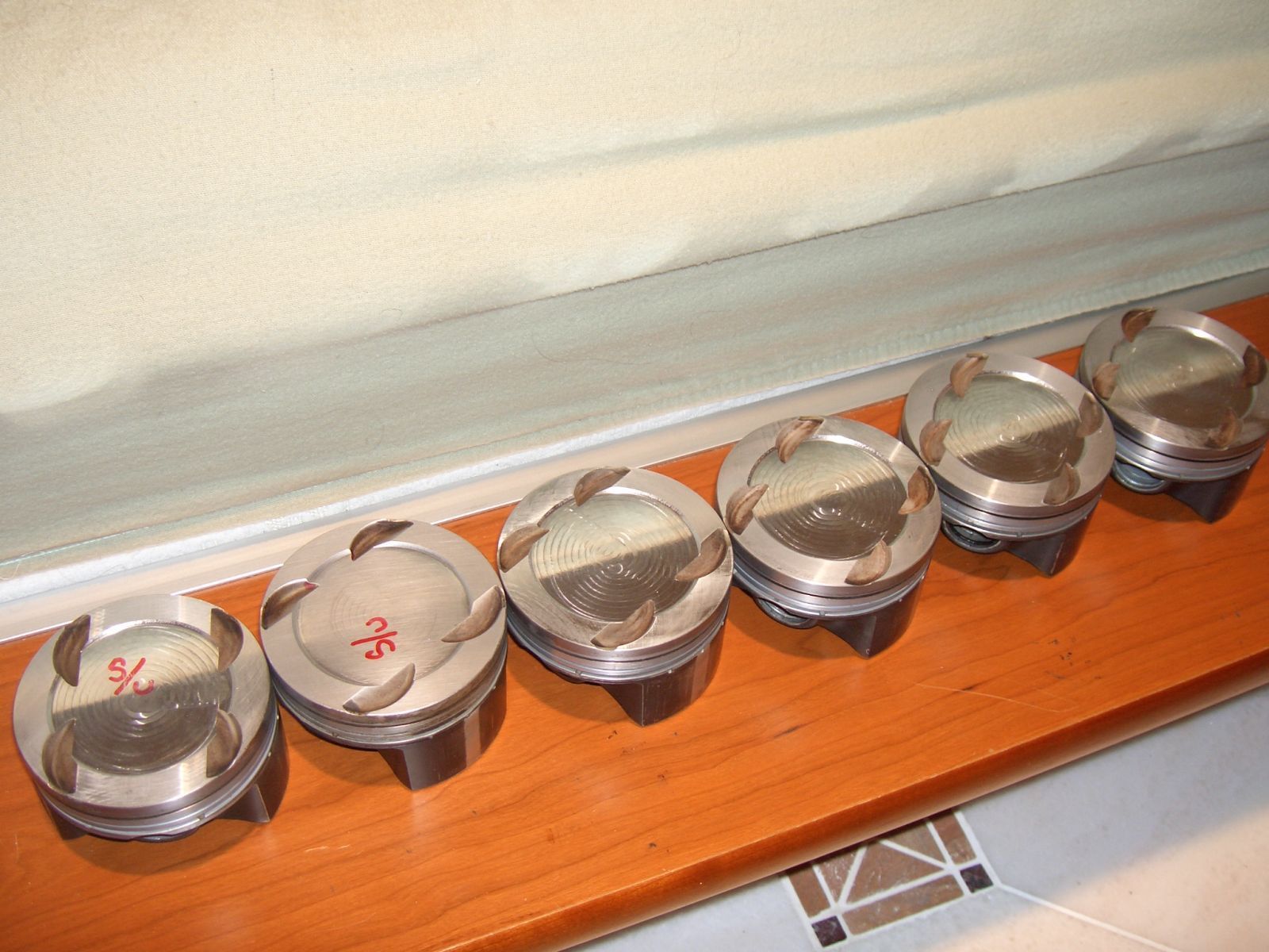

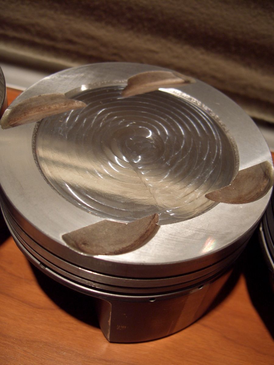

Pistons are done, and they are shiny on top ! Will be working on installation tonight.

Holy crap! Those look like aftermarket boost pistons. Lol Good job.
