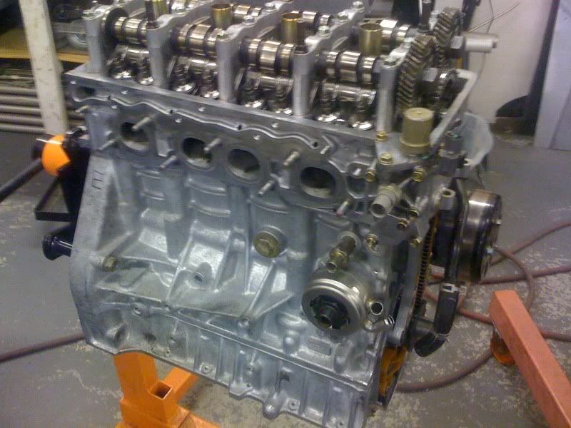

My block was all put together, just got some bolts from majestic that I needed to torque the oil pump (why did they use such a long bolt!). Head is all bolted tight, just need to put the valve cover, front cover and oil pan on now. All the motor stuff is the same as my original post just added ferrea valves like I had planned and went with OEM bearings. Got the blox intake gasket and the holes need to be opened up before it will fit, kinda lame but no biggie.

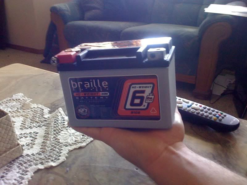

Got my battery

Got my battery
