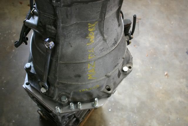

More parts, not so much work getting done but have almost all the mechanical stuff I need.
Got everything I need for the suspension, everything is new except the lower control arms that I got new balljoints and poly bushings for.
Got my transmission, 05 350z with 60k miles.
And last week mazworx got down on an adapter plate for it, monday they cut the plate and today they test fitted it. Should be here next week.
Adapter for the 350z pilot bearing into the s2k flywheel
No cutting of the bellhousing, they are gonna give me some measurements and competition or whoever makes my clutch can make me a spacer like this one.
Hopefully next time will have some better updates, but was pretty stoked about the adapter plate getting made and wanted to share.
