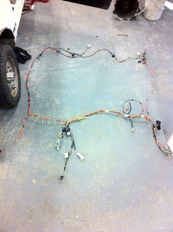

Nothing too special but got some work done. My friend Mark came up from portland (works at PSI) to do my chassis harness.
Heres the whole under dash and engine bay chassis wiring outside the car.
