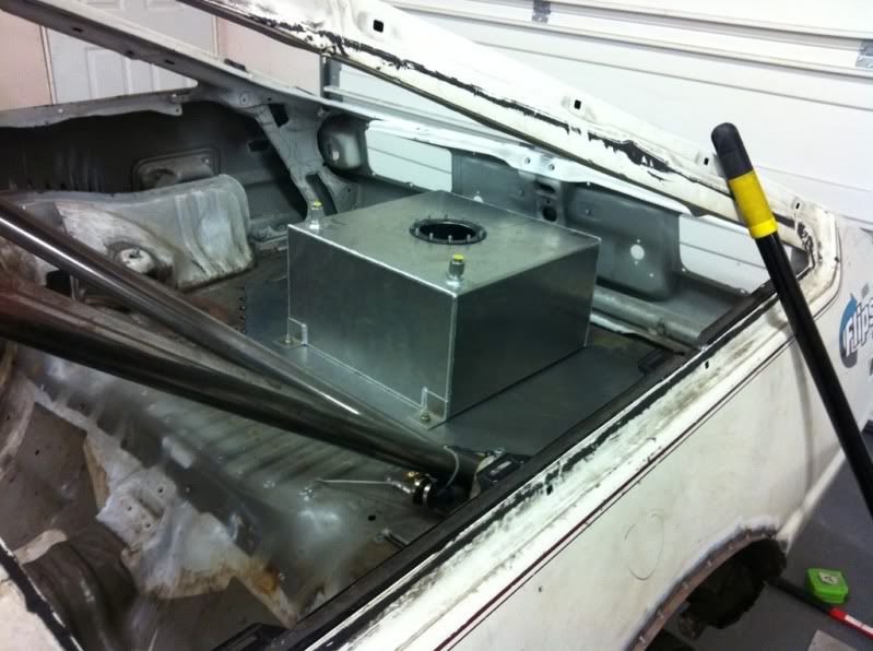

In other news I made mounted my fuel cell, today I will probably seal up my tubs and next week after the seat is mounted I could maybe paint the interior.
