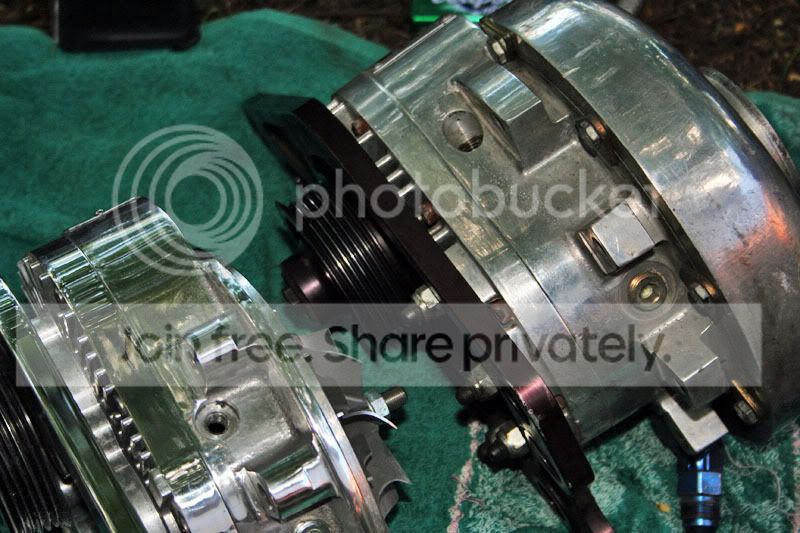

I came into this sub forum looking for something else and found this instead!
On a CT kit, the oil feed lines are different.
Here is the N1000 next to the N1500.
Notice the 2 holes are different.
You need to buy this N1500 specific piece from Paxton (notice it is female piece):
Then fit it in as intended:
But then you have this problem:
So you need tobuy an adaptor piece from any local hose fitting place for about $3.
Which will look like this:
And here is the N1000 specific nippler for comparision ( notice it is a male piece):

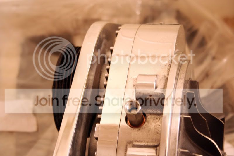

This is what happens when you use the original N1000 intake arm:
This is the reason why:
(if you meansure your own you will find it is of smaller diameter)
The old N1000 one actually squeezes INSIDE the volute secured by nothing.... as seen below, however for fear of the impellers chopping it up and going through the S/c -> aftercooler -> manifold -> and finally your motor, I decided this wasn't going to suffice:
So I ran without one whilst the car was off the road:
And here's the N1500 impeller for shits and gigs!
Then I had the metal one welded up, made and polished to fit snugly in with the rest of the engine bay.
Notice my metal intake where it goes into the Comptech airbox? Cost me about $200 to have fabbed, welded and polished.
This is what I guarantee you they were referring to by inlet & intake. No need to change aftercoolers or front mounts etc.
