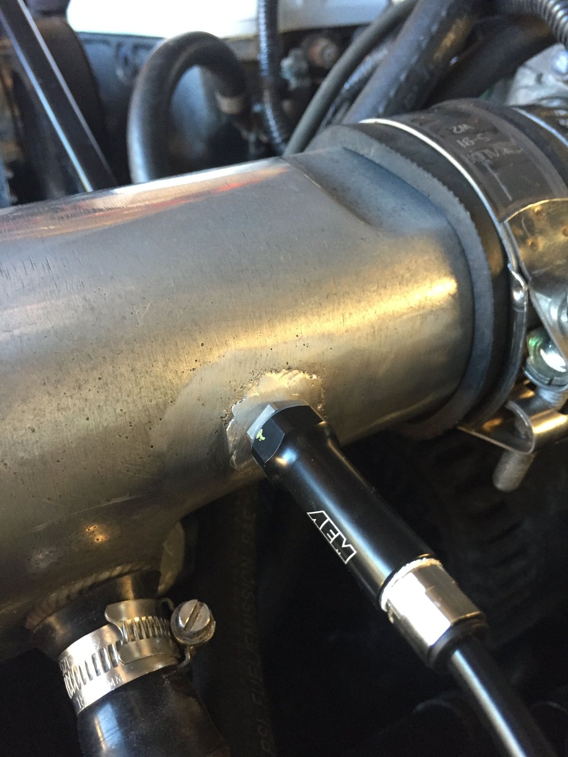

So fitted my water meth kit, but haven't had chance to test it as I've blown my diff and I'm getting a replacement built by puddymod.
But here's my install so far.
Just need my new diff and SOS TB to arrive and I'm off!

Old Jul 13, 2017 | 10:43 AM
  #198
volcomboy390's Avatar
Joined: Jul 2012
Posts: 572
From: So Cali
Let me know how this works out..... Iv been considering it but not sure I trust it to make power. Sounds good for cooling though.
Im curious if power can be made just by having a cooler charge
