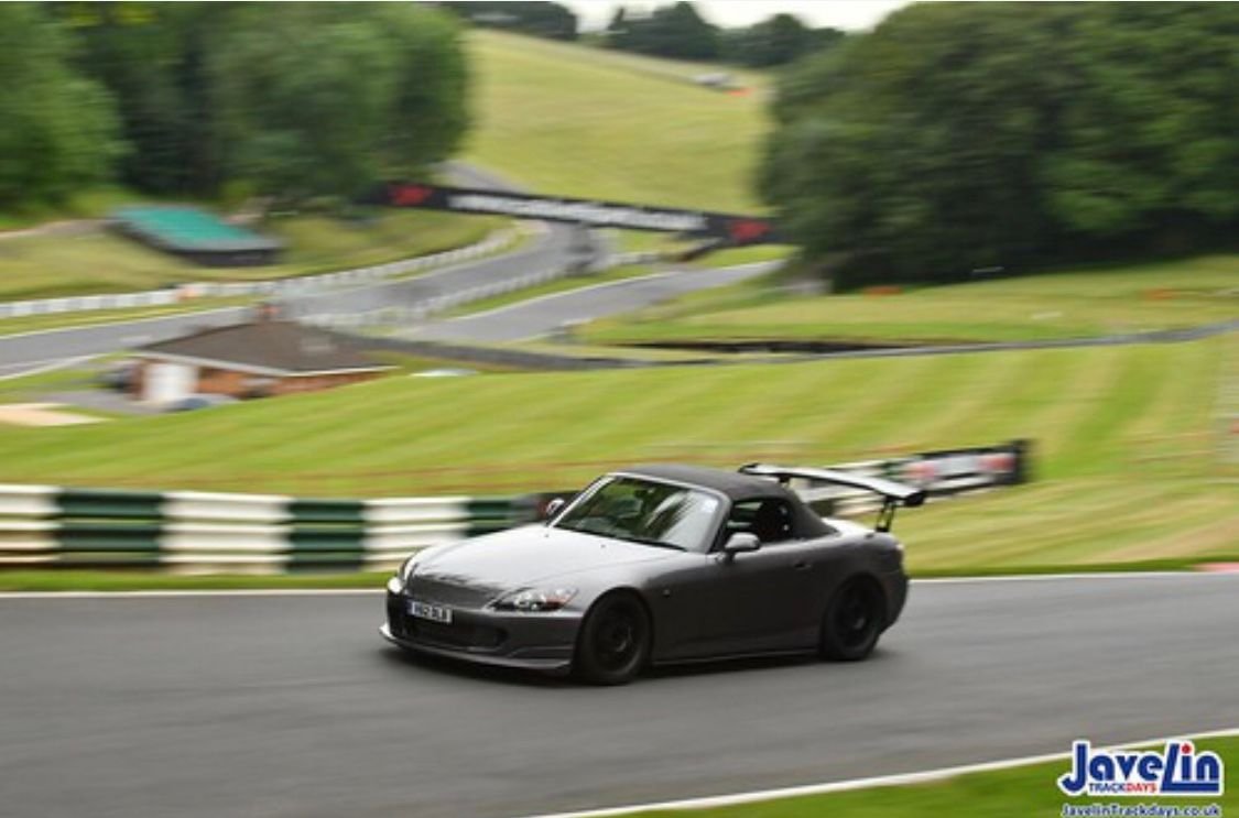

Completed another Trackday running meth. Was good, did 15 consecutive laps.
AIT stayed at ambient (25’c)
Oil hit 110’c at peak
worked well again
