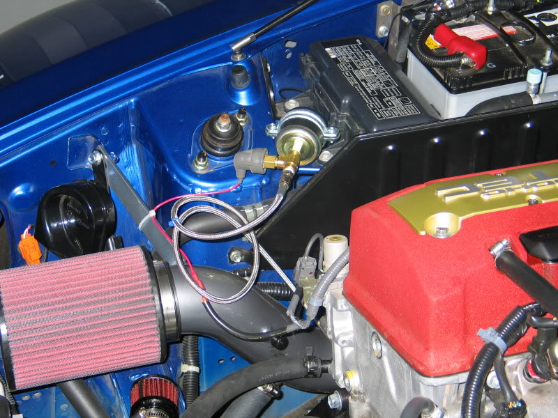

I used a Jaz 1 pint vented catchcan with 3/8" fittings (I should have gotten the natural one so I could see how full it is).I mounted it with a simple L bracket I fabricated from 3/16" billet brass ( an L bracket from Lowes would work great) . I used the mounting bracket for the rad. overflow as a drill marking template and put them together using some longer screws .I unscrew the catchcan from the L bracket to drain it since I actually trimmed the nipple end of the petcock with a hacksaw to make sure it had more clearence.I did smell fumes coming off the catchcan in that location so I plumbed the filter remotely and placed it near the intake.Draws in the fumes if I'm at a light so you can't detect it at all.Simple ,easy ,cheap.I also included a pic of my remote oil sending unit which holds both the factory and autometer senders. http://www.maperformance.com/jaz-one-pint-...-catch-can.html
