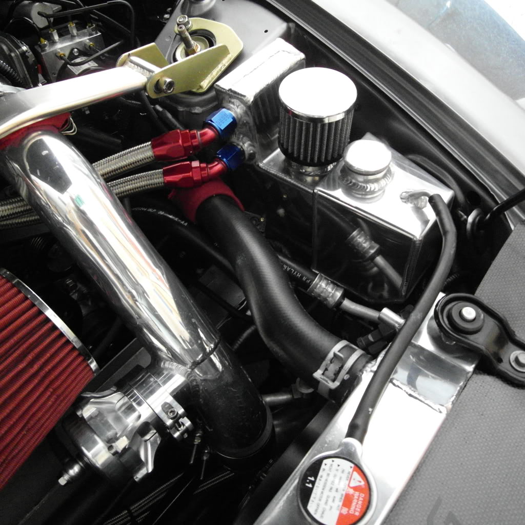

Blue Ridge Motorsports Oil Catch Can with coolant tank
Pros: its pwettyy and shiny and has a nice custom fit.
-10an lines allow good amoutn of blow-by escape to be functional
cons: the coolant valve is welded facing forward- it needed to be torqued to the right so the hood could close, and also the breather button had to be cut so the hood would close. im not sure if blueridge has changed this since.
I need to repaint the head again one day...

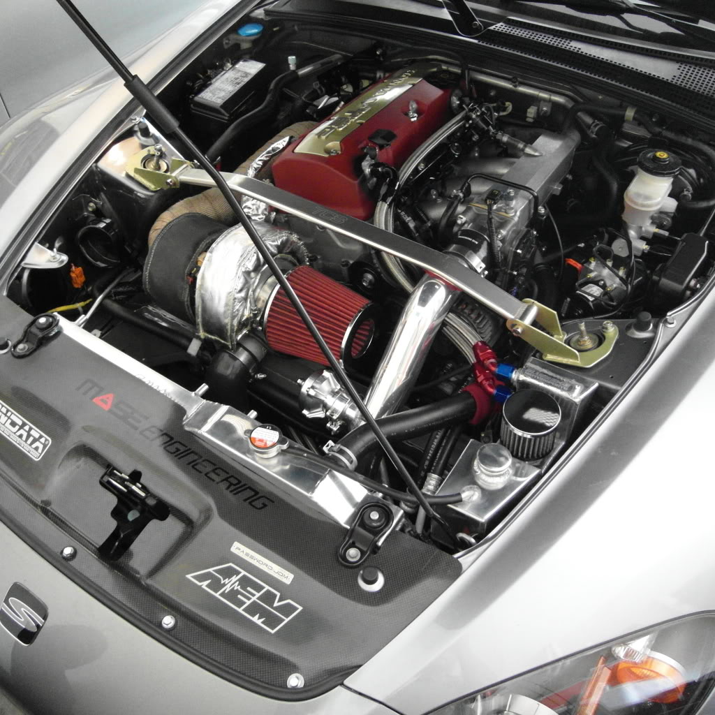

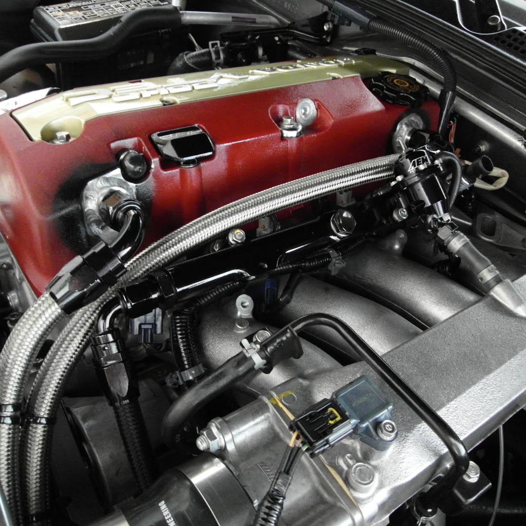

Both OEM vents Tee'd into one line into a baffled catch can and vacuum provided by the GTX30R. Great suction even at idle
If the turbo inlet to catch can line gets coated with oil I'll add a smaller catch can that uses a filter material

Posts: 1,308
I finally installed my Saikou Michi dual catch can today. Here are some pics. It's a very nice piece, and seems well constructed. Price was good too considering it's a dual. I used fuel hose from AutoZone and some hose clamps. Maybe one day I'll up the bling factor a bit...
I'm not sure this is the permanent location for it. The hoses are so long it looks like an octopus.
