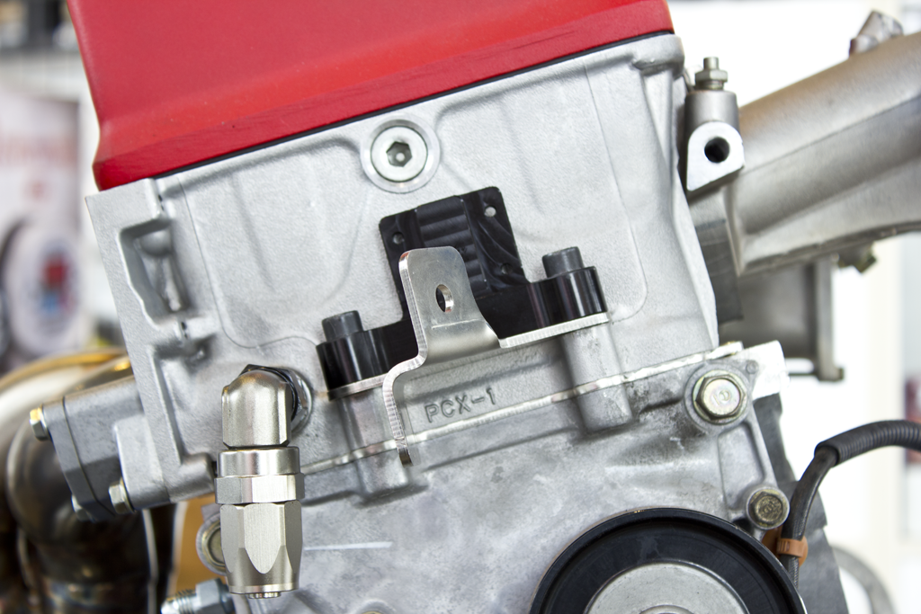

Originally Posted by TerminatioN' timestamp='1339697153' post='21781839
Did you ever figure out if this was compatible with an oil filter relocation unit that was mounted in the same area? I know you were talking about it in another thread... It looks like they could be stacked, but its hard to say without having it in front of me.
I would love to have the item. Just worried about its compatibility with my oil filter relocation.
Can take pictures of my setup if need be.
We would need to see pics of your setup especially the area where it's mounted to the block, preferably an aerial view.
Originally Posted by MrC@PTUNING' timestamp='1339698855' post='21781944
[quote name='TerminatioN' timestamp='1339697153' post='21781839']
As per your request:
Thanks.
[/quote]
How thick is the sheet metal of the welded braceket on the relocation kit that is bolts to the block (thickness underneath the two socket cap screw). BTW, that relocation bracket looks like it had a tough life, it doesn't look like the passenger side socket screw is actually securing the bracket--the holes looks too big. Anyways, the ODB kit can mount over the relocation bracket, just like it does on our turbo kit's intake bracket (see pic below), we will just need to provide you with longer fasteners.
MrC
Originally Posted by TerminatioN' timestamp='1340911162' post='21819289
[quote name='MrC@PTUNING' timestamp='1339698855' post='21781944']
Thanks.
[/quote]
MrC
[/quote]
Its about 10mm thick.
Lol yeah, it has had a tough life. Function is unaffected though.
Awesome, so longer fasteners should make it work? In that case I'll definitely be picking one of these up as soon as I can afford it.
Thanks.
