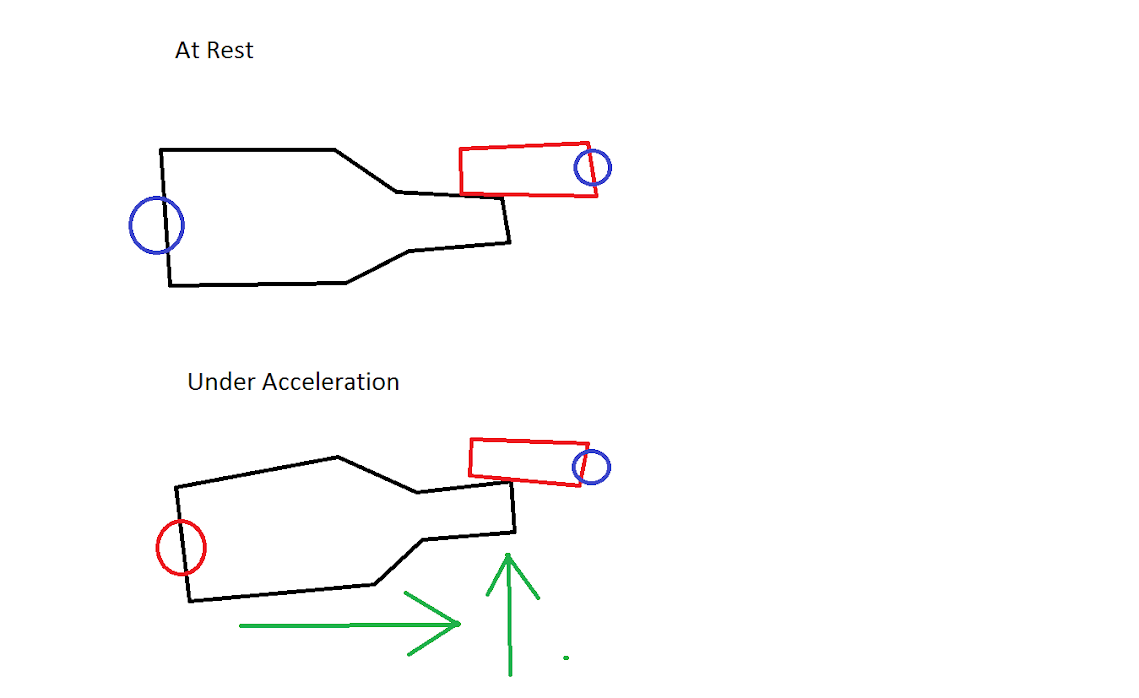

Here's some mad jdm photoshop that shows why ... the other kit creates a twisting point at the front mounts due to forces applied to the housing when under acceleration. The blue circles below represent where the mounts are fixed on the car, the red square is the mount, black shape is the diff. When the diff is pushed up by acceleration the 2 things want to separate. This separation simply twists the front mounts off. You could use the heavy ass iron t-bird housing but you'll only bend the housing instead of breaking. we use a different, much stronger housing and the front mount is tied to the rear mount which totally eliminates the twisting forces.
We'll have an "official" thread on the kit next week, testing is nearly complete.
Also keep in mind that I had a ford 8.8 in my car long before anyone else had a kit. I originally went the same route they did, I broke everything and quickly realized that it was a bad design

Fbm kit needs the steel case because the front mount puts a twisting force on the front mounts that the case is not designed to handle. This is far stronger and lighter. Ive got 2 cases here from fbm kits that are busted. Our kit won't break because the patented cradle eliminates that twisting force. The transfer of load follows the path ford designed the case to handle as well as transferring those loads to the s2000 bushings in the same manner those were designed for.
