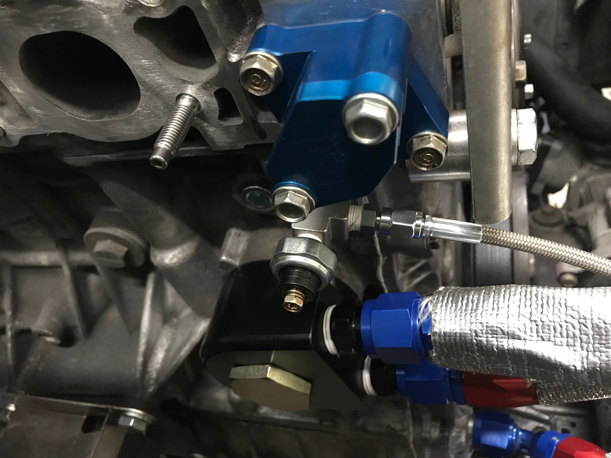

Girdle or timing cover is best for the return, use this fitting in the link for the oil feed. Here’s a installed picture of it also.
Stock Oil Feed Adapter
