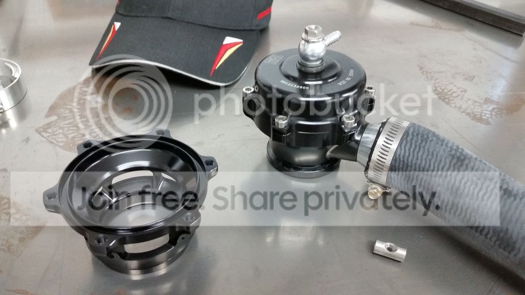

Today I purchased and installed the parts needed to convert my Tial QR into a Tial Q. Next step is to FINALLY install the SOS 3.0In pulley and street tune it. I have had the pulley for a year now, lets see when I get to it...

Hey mate what do you expect from converting the QR to a Q?

I expect a much louder and annoying blow of valve and the ability for the BOV to prevent blower compressor surge with a small pulley on the blower.

You're really going to be over spinning the blower with a 3.0" pulley on the N1200. What Rev limit you going to be having?
Nice! I'm running one one of those too. Only thing I don't like is it feeds hot air into the intake.

Can't you just discharge the air into atmosphere? And plug the hole on the intake?

I vent to atmosphere through he QR body because it quieter than the Q, it just doesn't flow aswell.

It's just really loud when it's vented to atmosphere.

What about the QRJ? It vents just as much as the Q right? But it has a hose connection to direction the noise towards the road?
I don't believe it does vent as much as the Q. You just have to look at the design of them both to see
