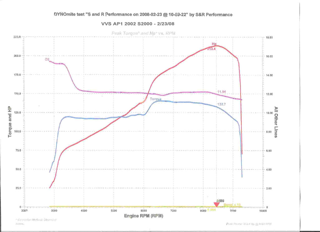

Junky and Camu, I have some questions. If I change my power curve N/A to a much more smoother and linear one, with berk header, SAFC ect...will the power curve be maintained and enhanced with the SOS SC? I understand that the boost will be based on RPM. In theory, I would get my power sooner correct? I also keep on reading that with the berk header, there will be some high end loss, so would I suffer from even more of this loss by adding the SOS SC? Anyway to correct that with the NEO?
My goal is to get the following rpm/torque curve:
http://www.s2000performanceparts.net/temp/dyno01.jpg

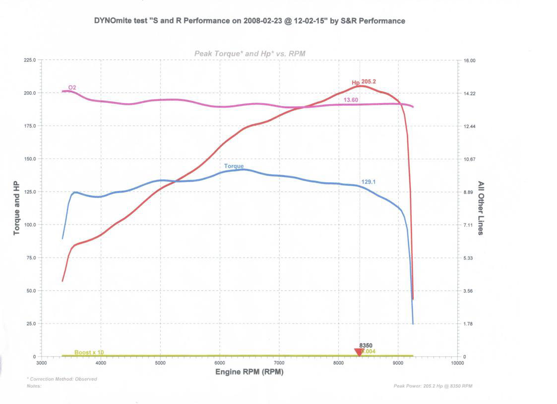

As opposed to most regular rpm/torque curves you see:
http://www.s2000performanceparts.net/temp/dyno02.jpg
Notice that the max power is lower on the first one, but the power is more linear and comes sooner.I would then eventually add the SOS aftercooled kit.
Will this approach work?
Erik
well then, you want my power band brotha!
225+tq from 4500-8000rpm.
200+tq from 3000rpm up!
more power then stock peak power at 4700rpm. super hard linear pull. max power made at 8200RPM ROFL!
and this was on my 8psi dyno. i am now at 9.5psi. god i need to get this thing dyno'd again.
SOS is no doutb a nice kit, and seems improved over VT and CT. but your still gonna be missing the low/midrange. at same boost levels, the roots blower will meet or exceed a centrifugal blower. for instance, the SOS 8.5psi kit made 344whp on dynojet, i made 349 on 8psi on dynojet. peak was damn near the same, but i promise the meat and potatos was quite different
