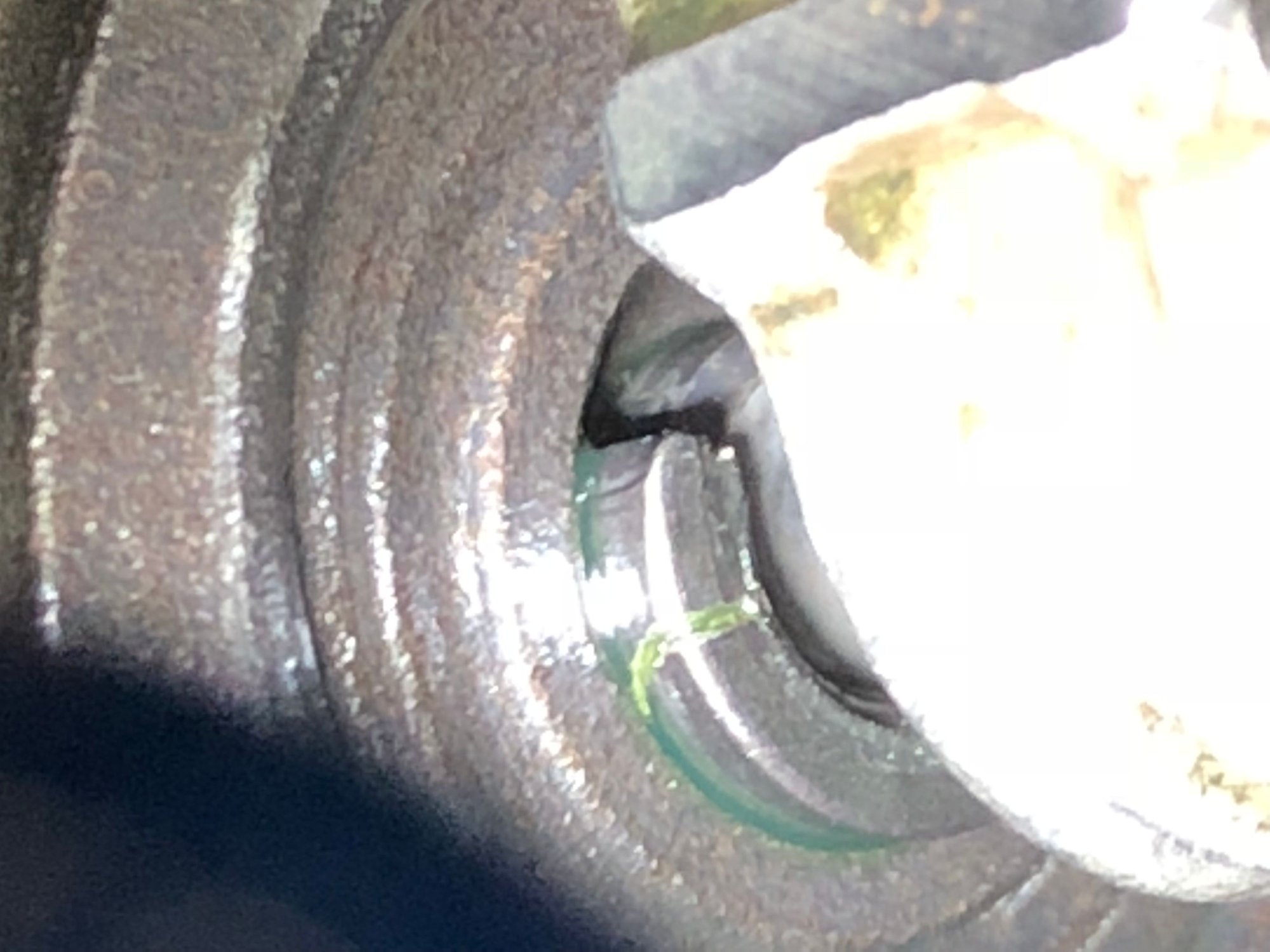

Found the limits of BC valvetrain.... 28lbs on a 72mm turbo lol
750-800 is my guess on power the night she almost dropped.
My guess, started to valve float. And dropped a keeper, cracked the one that’s still holding the valve lol
i got
lucky!!!!
i got
lucky!!!!
you are a lucky man. Glad the valve didn't drop.
I wouldn't say thats the limits of the valvetrain. I just think something may have failed.

How high were you revving to?
Old Sep 14, 2018 | 06:08 AM
  #76
AP1Chief's Avatar
Joined: Dec 2015
Posts: 812
Likes: 119
Stock limit
