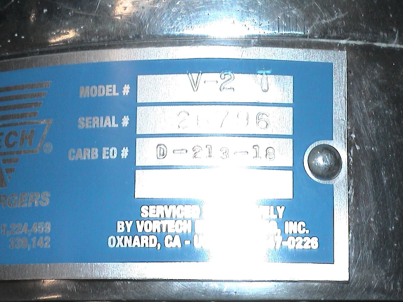

I will add that Vortech is also not CARB legal
Actually, I think your both right. The early version for the AP1 is CARB certified- the version for AP2 DBW is not - yet.
