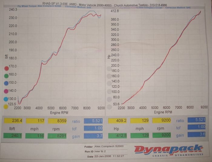

Dyno 1.22.08
Turbo/Supercharger Kit: Comptech
Supercharger Make/Size: NOVI 1000
Motor: F20
Compression Ratio: 10.5:1
Specs: Alaniz Head, 3.25" ASP pulley
Injectors & cc: RC-650s
Fuel Pump: Wallbro 255
EMS: AEM Series I 1052
Fuel: 91 Oct.
PSI: 14.5 PSI/Ect.
WHP: 413 WHP
WTQ: 240WTQ
Dyno: Dyno Pack/
Additional Specs: Tuner: Church, Alaniz Head, Mugen Cat back, Megan Header, Megan test pipe, HKS ssqv, .070 cometic gasket, Mugen fan switch and rad cap, Proflo enlarged TB, ACT clutch and flywheel, axial flow short shifter, Hondata intake spacer, Krank vent, AEM FPR, AEM wideband controller, Tried a 3" custom (turbo mafia) exhaust and a bdl Throttle body and matched intake didnt like it at all. Exhaust was too loud and the throttle response off the bdl was too on off and was sticky.
