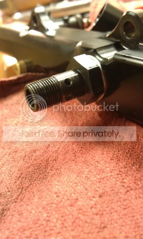

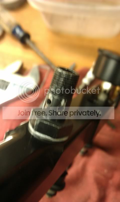

I went through a very similar situation this summer trying to get my car tuned and running right. I tried both of the new 340lph pumps, but was dropping fuel pressure with both.
First setup:
FB340 w/brand new OEM sock filter -> hardwired off battery in trunk -> stock fuel rail -> stock FPR
Didn't have a fuel pressure gauge, but car was going lean over 7K rpm's. Was on the dyno for over 3hrs, tuner couldn't get it running right no matter how much fuel he dumped in at high rpm.
Second setup:
Aeromotive 340 w/OEM sock filter -> hardwired off battery in trunk -> AEM S2000 fuel rail -> AEM FPR (using small internal orifice that came installed) -> K-Tuned 100psi fuel pressure gauge.
Car seemed to run a little bit better with this setup, but ran into the same issue on the dyno. With the fuel pressure gauge, we watched the fuel pressure rise from 50psi (base) to ~65psi then just drop to around 40psi at redline.
Tuner started talking crazy talk with me...dual pump setup, surge tank, etc. I knew I didn't need all that for 12-14lbs of boost on 91 pump gas, sooooo I went to another tuner.
Next/New dyno session with new Tuner
Third Setup:
The only thing I changed was pulling the pump out (again) and adding fuel line specific hose clamps on the hose in between the pump and pump hanger.
Once again, car ran great on partial throttle pulls but lost fuel pressure at high rpm's
Forth setup:
Went back to my tried and true Walbro 255 w/another brand new OEM sock filter -> new fuel hose between pump and hanger w/fuel line specific clamps -> brand new OEM pump hanger -> AEM fuel rail -> AEM FPR (switched to medium sized orifice) and dropped fuel pressure down to near stock ~45 psi IIRC
Also, the shop had me drill a few holes into the fuel supply fitting on the fuel rail to allow fuel to flow into the rail faster
Sure enough, fuel pressure held strong all the way to redline with this setup.
Not sure if it was the pump or drilling out the fitting (or combo of both).
Hope this helps some of you out. I know how frustrating (and expensive) these issues can be.
