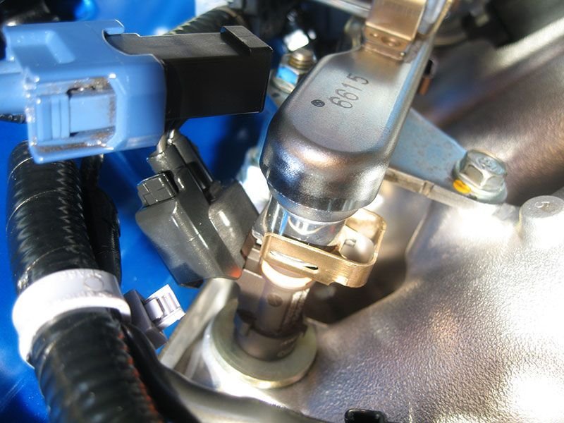

Looking at the engine from the driver side of the engine bay, the first injector closest to the radiator ; the wires follow from left to right go
1)Yellow/black, brown
2)Yellow/black, red
3)Yellow/black, blue
4)Yellow/black, yellow
Does polarity on the injectors count? I assume I just wire in the ID 1000cc injectors with the wires in the same order as before with the new injectors clips and injectors, right? should be just plug and play correct?

correct, injectors do not have polarity, they just work off of voltage pulses

Do the ID wiring clips come with different color wires on each clip? Like one black and one red? If so, all the black will go to the yellow/black wires on the harness and the other color will go to whatever other wire color corresponds to that set of wires on the wire harness.

www.t1racedevelopment.com has no-cut adapters. Worth the money IMO.

Send a few bucks and get the PnP pigtails. Makes life a whole lot easier. T1 should have them
