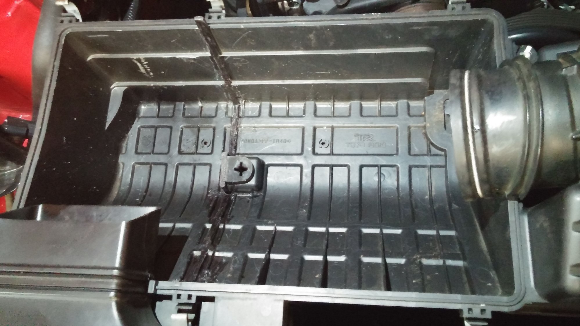

Just did the cut out for the Air Box on my 2007 S2000, wanted to share my method of cutting out the baffle which worked well. Using an Oscillating tool with a cutting blade I was able to get a complete cutout while the Air Box was still in the car. I understand that you will get a 5 WHP gain and better gas mileage with just this change.

Air Box Mod second picture

Gutted stock air box, AUT cooling plate, K&N OEM style filter, Samco intake hose, wrapped OEM header and a Berk header back my car made 219 HP on the OEM ECU last Friday.
Car is an '00 w/ 71K miles on it.
AEM EMS V1 netted another 15-20 ft/lbs of torque over the stock ECU but peak HP remained the same.
