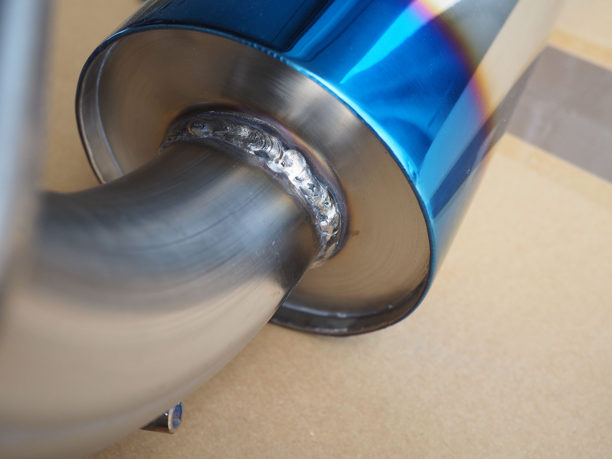

I’ve seen a few J’s titanium exhausts and a good few of the welds on each we’re not very impressive. Of course not as bad visually as what is in the OP, but that’s because they don’t MIG weld the titanium.
I purchased an Amuse and it was the only JDM titanium exhaust I have seen with great temperature control and purging of the welds. This is what will keep them from breaking long term. Of course their middle muffler perforated tubes are still only tac welded to the muffler body though :/

I received pictures of a 70RS from Yasu of Js Racing North America and the welds were still pretty inconsistent:
