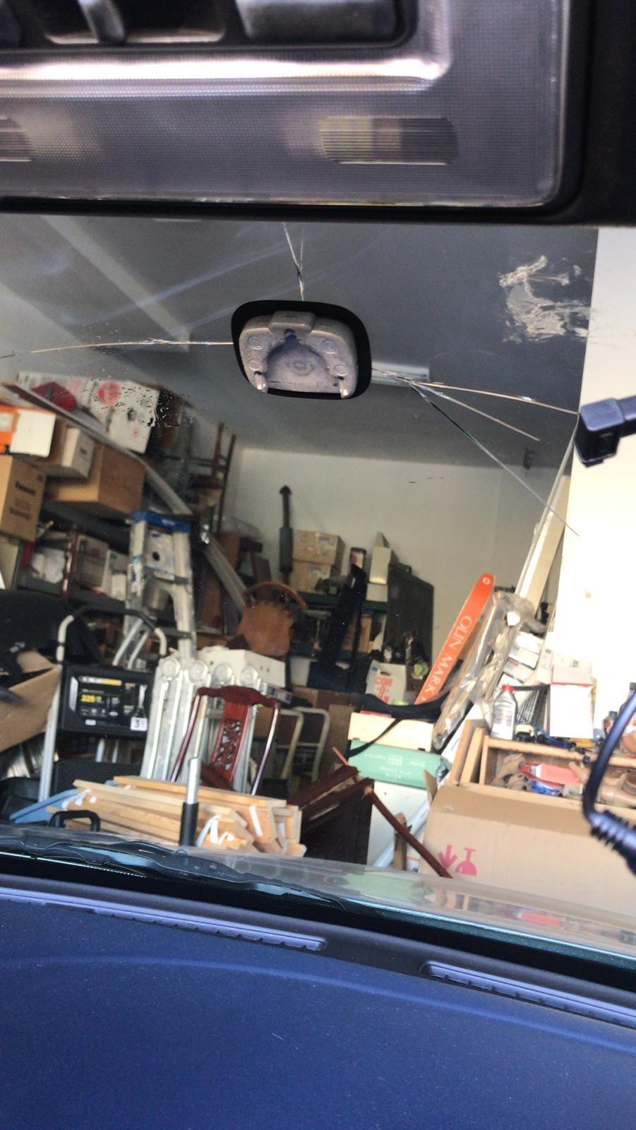

The latest update to this saga... ended up getting the same mirror. Tried to remove the old mount with a butane torch. Looked so easy on YouTube...
Whoa !!
Damn, I'm worried about this happening; this is the only thing that is stopping me from trying to remove the button.

Ouch, sorry to hear that man. I used a 300W shrink-tubing heater. It was extremely slow to get the adhesive flowing but it worked fine. Do you think the cracking came from the heat, or did you just pull at it kinda hard?
