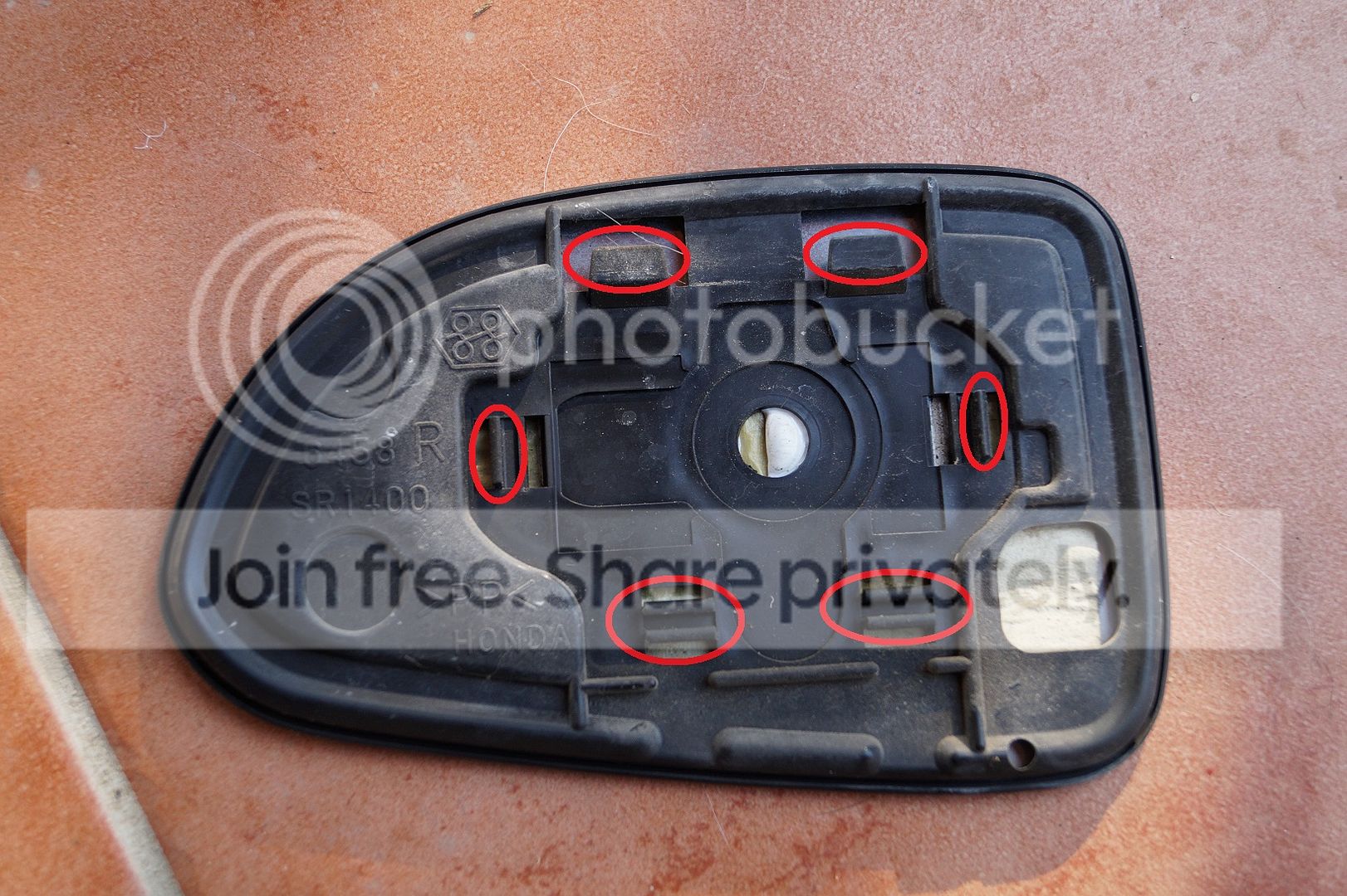

So i just removed the glasses and found zero play in the mechanism/motor behind as well. The play is on the mounting tabs, so the fix is pretty simple. I applied a minor amount of grey rtv on all the contact points of the tabs, enough to eliminate the play but still be able to pull them if ever needed. Rtv has to be applied on the tabs circled with red for anyone else having the same problem. For the upper tabs/hooks, apply rtv directly on the mounting point of the mechanism, or apply rtv under the tabs of the glass mount with a toothpick, under, not on.
