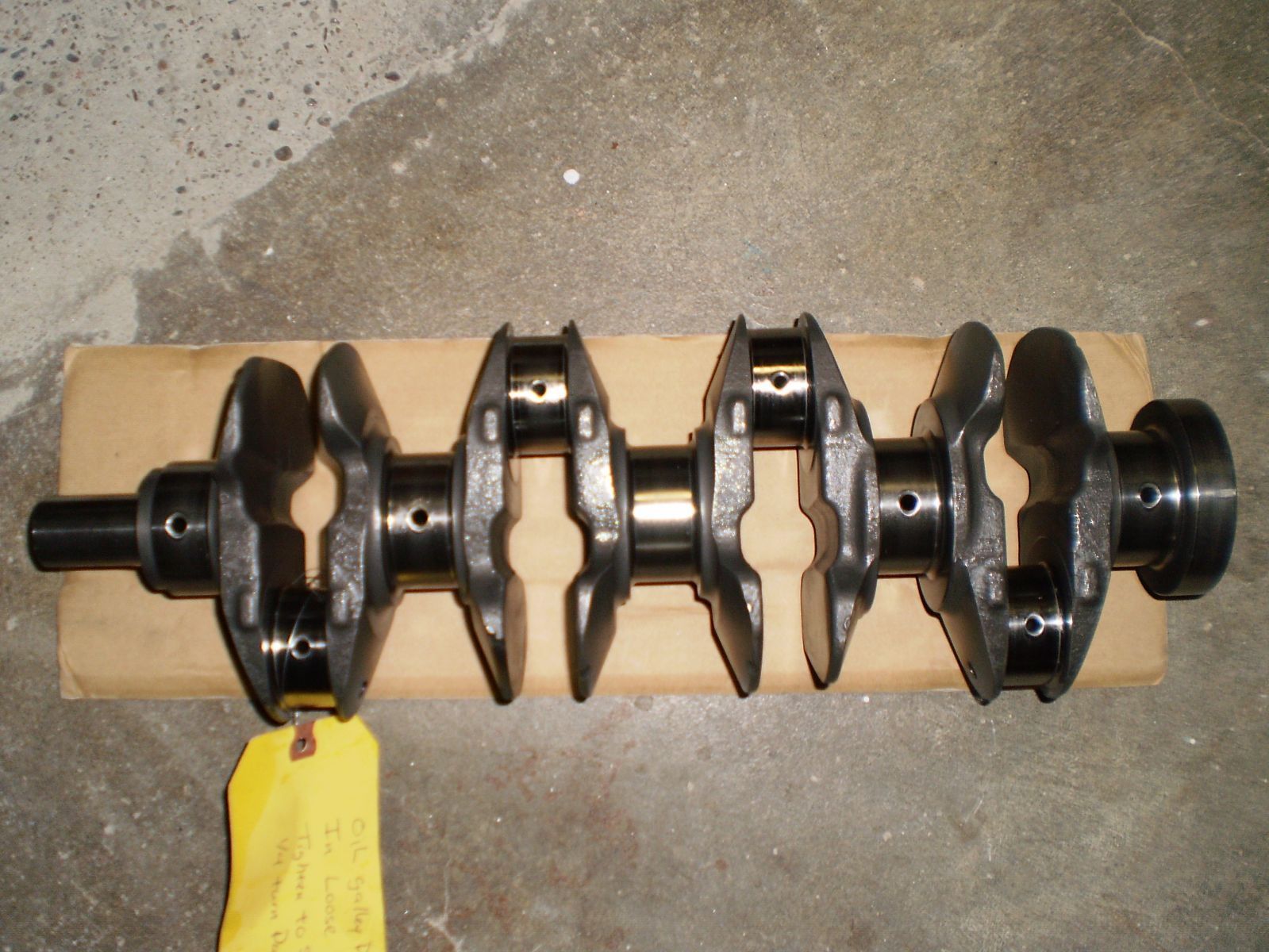

It was my crank that is for sale. It is setup to accept the stock big end width of the rods, a much safer route than the narrowing of the rods option. It has been lightened, knife edged, micro-pollished and nitride hardened. If you buy the crank from a TSX and have this done, you will spend $1600. I know, because I have done several. These cranks support a lot of power. I have never seen one fail that it setup like this, and several are in the 750WHP range with boost. Castillo claimed that a few run close to 1000WHP for drag purposes and last, but those are high abuse with low mileage. The back of the crank has been shave to accept the S2000 crank. So zero machining of the crank or rods is required. Just use H22 rods and pistons and go.

Perfectly reliable for a daily driver. Minor work on the block for clearancing, and minor work on the piston skirt for oil squirter retention or use b-series oil squirters. I have seen people with these just run higher fuel pressure to compensate for the added displacement, but that was on an AP2. AP1's would require even more of a pressure increase, and then the rev limiter would be too high. You can safely spin it to 10k rpms, but most with this crank stop making power between 8k and 8.5k rpms. So the factory rev limiter on the AP2 is perfect. You need to do your own math on CR with this crank, for a prelude H22 piston made for 8.5:1 will come out in the 9.3 range depending on your choice of gaskets, head work, etc... This relationship is not linear, i.e. you will not always get the same CR differential. Best results are with a sleeved block, and roughly 10:1 H22 pistons. You will end up around 11:1 with about 270 WHP on an EMS at 2.4L depending on supporting mods.
