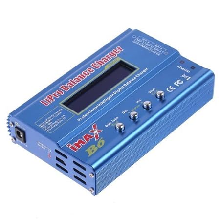

I own the Deka 18L, and no you don't NEED a trickle. Chargers can be cheap, though. Another lithium manufacturer called ballistic sells this charger:
http://www.ballisticparts.com/produc...gerBalance.php
BUT, notice this amazon knockoff that's much cheaper?
http://www.amazon.com/IMax-Digital-b...ef=pd_sim_t_21
This charger works with lead, nicd, nimh, and lithium batteries so you can charge most anything with it. Just pair the above charger with a 12v DC adapter. I use the adapter from my old lcd monitor. As a bonus, when I have downtime at the track I can charge my rc car batteries off my car battery
. Or charge a cordless impact battery / walkie talkie battery if I wire it correctly.
The shorai balance port should have 5 pins in it, meaning its a 4 cell lipo battery (4 positive terminals, and one common ground). The LCD readout of the charger lets you monitor the voltage of the individual cells. That's the only real way to check if the cells are matching in performance, which is important since Shorai's website says they don't make a battery approved for automotive use yet.
. Or charge a cordless impact battery / walkie talkie battery if I wire it correctly.The shorai balance port should have 5 pins in it, meaning its a 4 cell lipo battery (4 positive terminals, and one common ground). The LCD readout of the charger lets you monitor the voltage of the individual cells. That's the only real way to check if the cells are matching in performance, which is important since Shorai's website says they don't make a battery approved for automotive use yet.

There are a couple of different brands of balance plugs out there, and I don't know which the shorai uses since I don't own one. Best bet is to bring your shorai and charger to an rc plane hobby shop and have them tell you the right plug. The plug in the picture is $5.50.
As others have mentioned, you can go for many months without bothering with a balance charger. But considering how shorai hasn't made a car-specific battery yet, it's nice to have a charger with an lcd readout of the individual cells so you can keep track of the battery health.
Lithium batteries have a resting voltage of 3.7v per cell, with anything below 3.0v or above 4.2v being a death sentence. With the shorai being a 4 cell, you need to be mindful of scenarios that would subject the battery to the danger zones of below 12.0v or over 16.8v. A dying alternator could kill the battery with it.

What exactly do I need along with that "cheap" charger from Amazon? It doesn't seem to come with cables and such...
I can take pics of my charger + accessories when I get home. What you would need in addition is a 12v DC power source like a laptop power supply and the 5 wire balance plug that mates with the shorai.
If you have your shorai already, your best bet is to search google maps for nearby hobby stores that sell electric rc planes, since planes often use 4 cell lithium packs with 5 wire balance plugs. Then you can use that balance plug with a volt meter and periodically check the voltage in each cell.
You dont HAVE to balance charge for longevity, you mainly want to verify that the cells are staying somewhat matched. If one cell does start to stray in voltage from the flock, THEN you need the balance charger.
