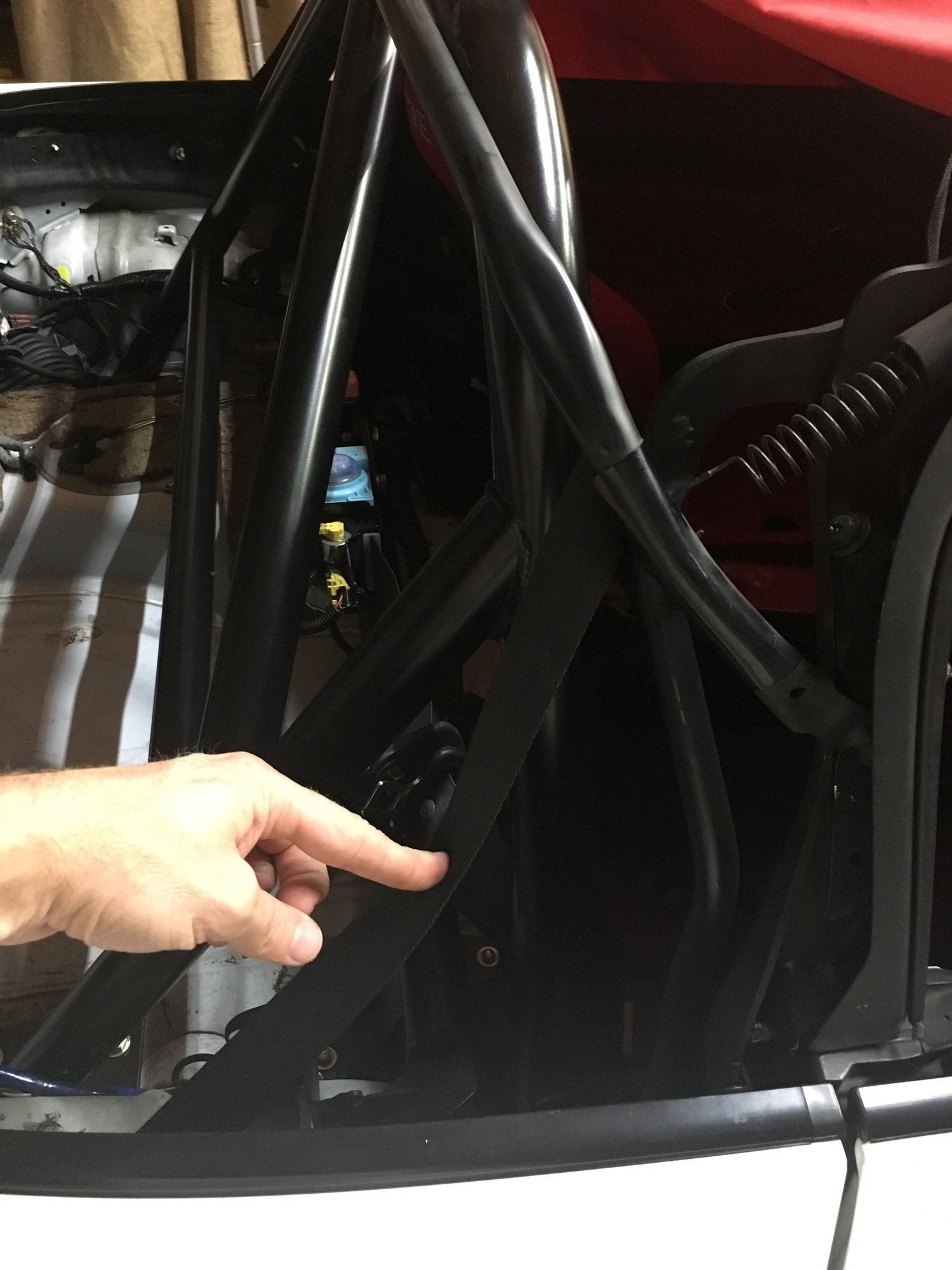

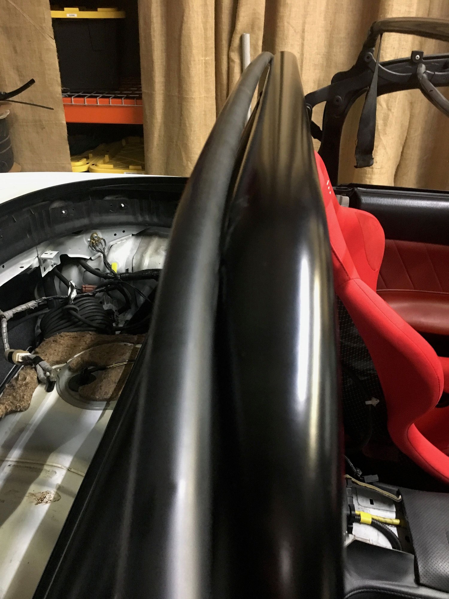

I'm hoping someone that has a Hard Dog (or other roll bar) installed in their S2000 can offer some assistance.
Could someone that has a roll bar in their S2000 perhaps measure the distance shown in the photos so I can see if my roll bar is built correctly?

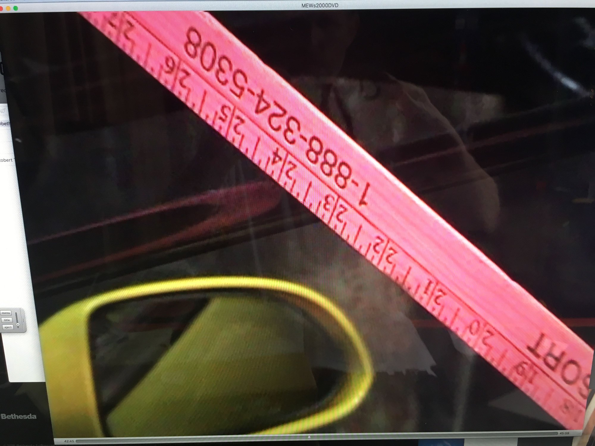

The Robbins top install video clearly shows that the convertible top bow that goes behind the roll bar should be 24 inches away from the back of the opening the top goes in as I show in the photo. Problem is: mine is 22 inches and smacking into the roll bar and the roll bar is preventing the bow of the top frame from moving forward a full 2 inches.
The photos with the pink yard stick is the install instructions from Robbins, the one yellow tape measure is what's happening on my car. I've also included a photo of how loose the straps are that supposed to be under tension and stop the bow from moving forward. Everything I'm seeing points towards the top roll bar being too far back, but I need to confirm this is the case.
I've already contacted the company that made the roll bar and they said they don't have a S2000 handy to make any measurements. So I'm hoping someone would be so kind to take a photo with a yard stick or tape measure showing where their bar is located, so I can share that with the manufacturer.
Thank you for any help! This is driving me crazy as I can't get the car back on the road or track to enjoy it until this is sorted out.

My top bar hits the roll bar like your pics show. Its never been a problem. It just leaves a little rub spot on each side and doesnt make any noise.

Same for me. The two bars are snug against each other. Hasn't been an issue for the three years I've had the roll bar installed.

Mine do not touch, but I installed the roll bar a couple centimeters forward from flush, to ensure the top could fully go down and up.
