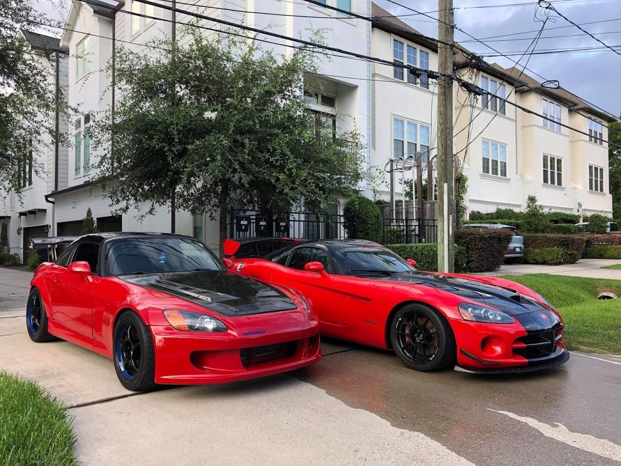

Hi all,
I just picked up my first s2k and will be using it as a dedicated track car. The car is a 2000 with 63k on the odometer, the color is NFR, I paid $11k. The previous owner began a track build but never made it to the track with the car. It needs a little work but it's a great start for me. I bought it with the following mods done:
Engine:
  • F20C with <2k miles on a fresh OEM rebuild
  • AP2 valve springs and retainers
  • K&N cold air
  • DC header
  • GReddy Ti-C single exit exhaust
  • Mishimoto aluminum radiator
  • Samco hoses
  • J's racing ECU
Transmission/Drivetrain:
  • Stock AP1 (<2k on new stockish clutch)
Suspension/Brakes:
  • Tein Mono coilovers
  • Rotora front big brake kit (330 mm)
  • Enkei 17x9 square setup
  • Dunlop 255/40/17 square
Exterior:
  • ASM wide front fenders
  • Shine ASM front bumper
  • ASM rear over fenders
  • VIS wing
  • APR splitter
  • Carbon hard top (unsure of brand)
  • VIS carbon hood
Misc:
  • Gutted (and I do mean gutted..) interior
  • Hard dog roll bar
  • Cobra racing seat (fits me perfect, it'll stay for now)
  • Scroth 6pt harness
  • Sparco wheel
  • Shift knob and some carbon interior bits
Extra parts given to me with sale:
  • 2 sets of buddy club seat rails
  • Spare alternator (needs to go in)
  • Misc interior pieces
  • Mishimoto thermostatic oil cooler
Plans:
  • Seat time
  • Seat time
  • Did I say seat time?
  • Proper coilovers, corner balance, alignment
  • Sway bars as needed to achieve the balance I want
  • Castrol SRF fluid
  • R888Rs or NT01s
My plans are kind of vague right now. In the long term, I'd like to bring the hp/weight ratio close to what my ZL1 1LE was.. something like 350 whp should be sufficient.
