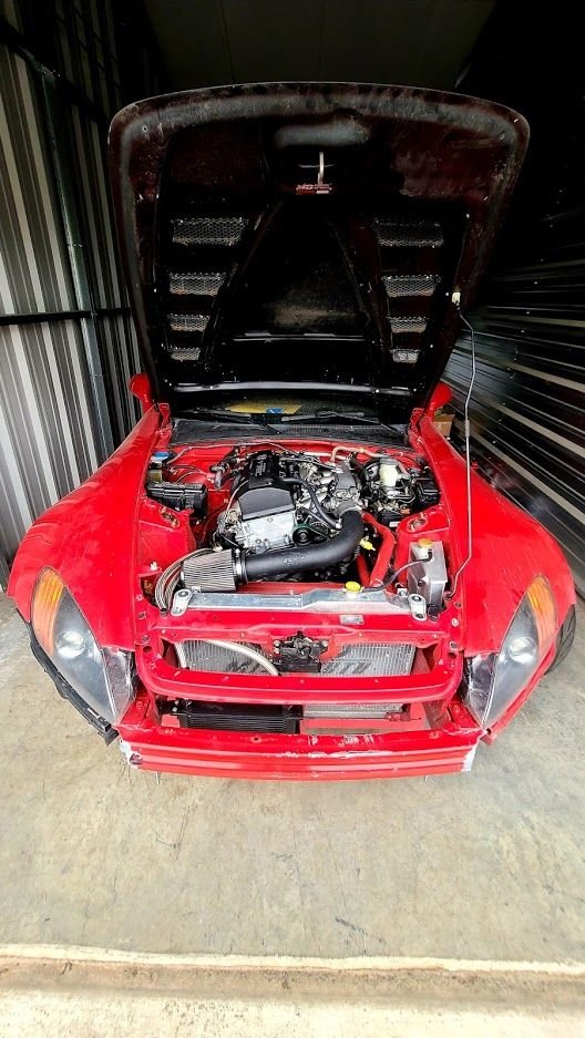

After relocating from Texas to Idaho in March, I recently found some time to put the engine and transmission back in the car. I also fixed the stuck subframe bolt by opening up the end of the frame rail, removing destroyed sleeve and bolt, and welding a new nut in place. Sliding the engine in from the bottom was extremely easy with a lift and two sets of hands.. took maybe 5 hrs in total to fix the bolts, prep engine/trans, install in car, and hook almost everything up. The car needs fluids and a new battery before it is g2g.

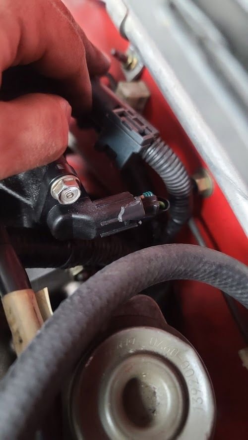

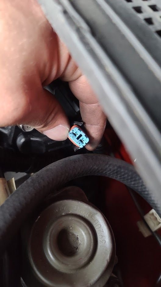

I've been trying to start the car over the last few days and have not had any luck. The car will crank, but will not fire. The car has a J's Racing ECU. Here's a list of things I've checked/verified:
  • Charged battery
  • Verified CEL functions and there are no active errors
  • Checked under dash fuses
  • Checked under hood fuses
  • Pulled and tested each spark plug/coil (grounded plug, cranked car, observed spark on all four)
  • Tested for continuity from negative terminal on the battery to the cylinder head, and body of the car
  • Checked voltage at injector clips
  • Verified spark plugs are wet with fuel
  • Sprayed starting fluid into the TB then cranked the car
None of the above resolved the issue. The car cranks and will stumble or backfire, but will not start. The plug for the intake camshaft position sensor is crushed but still intact enough to allow for the plug to connect. I guess this could be the issue, I'll test this weekend. Other thoughts? It seems I am getting spark, fuel, and assuming the timing was set correctly by InlinePro, that should be in order as well. So that leaves me with the car isn't firing at the right time due to the one or both of the camshaft position sensors not functioning correctly. I suppose it could be the crankshaft position sensor, too. Wouldn't these throw a code if they weren't functioning properly?
Edit: attached some pictures of the smashed camshaft position sensor connector.

Do you have an inductive timing light to check the timing? Put the pickup on the wires to the #1 coil. I know that it works with a running engine, but I never tried it with just cranking. Can see if timing is about where it should be, if it fires the timing light. I am not familiar with the ECU. Can you reload the tune to it, it you have it backed up?
The timing light was something else I'd thought of, I just haven't had a second set of hands to push the start button this week. I'll try to get that done this weekend.
The J's ECU is pre-programmed for a specific set of mods, as I understand it. I don't think it can be programmed. I do have two spare, stock ECUs lying around. I'll try one of those this weekend as well.
